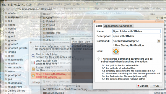

It's quite simple using the graphic interface rather than a script/terminal.
Edit>configure custom actions
click the + (add)
popup will open
in basic view tab, type "open with XNview" (or whatever you prefer to see in your right click dialog)
Optionally type in a description.
in the line labeled "command" click the folder icon on the right. this should open usr/bin, and you can select the xnviewmp (in my case) executable. The line will now read: /usr/bin/xnviewmp %f
Do not check the use startup notification box.
Click the icon and search for Xnview, choose an icon (or choose any icon you prefer!)
In appearance conditions tab:
check only "directories" and "image files" .... you probably do not want folders with only text files, or files of only .txt or .doc or whatever, opening in Xnview...
click OK.
You may need to restart Thunar.
To remove, or edit the custom action, simply select Edit>configure custom actions again, and you can edit or remove it from there. A common mistake in Thunar is NOT selecting the proper appearance conditions (folders=directories, image files) in that tab, and editing makes it easy to change that without starting all over.

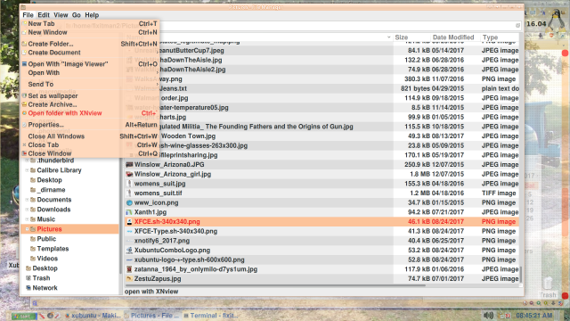

Now, when you right click on a folder, or on an image such as a .jpg, in Thunar, you can select your custom action.
Folders will open with XNview in the last folder view you selected.
Files will open in full screen (at least that's the way mine works) but you can just hit the escape button (or F11) on your keyboard, which will remove that full screen view and show Xnview opened to the folder the image is in. You can also right click and select full screen, which does the same thing.
