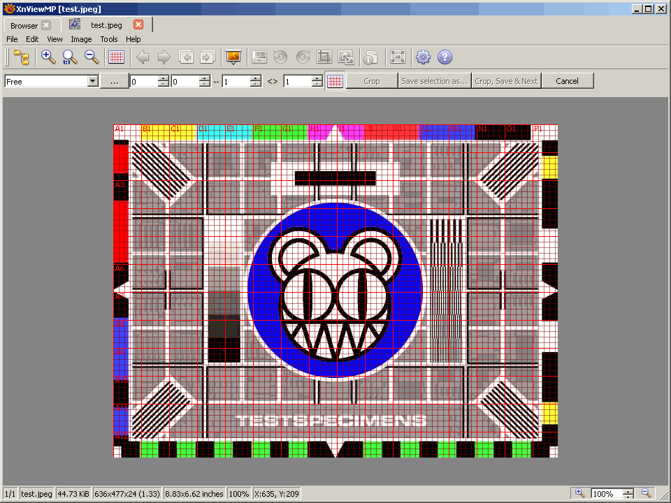

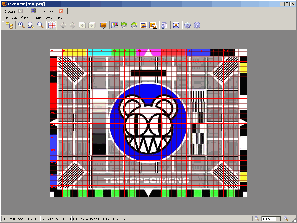

Previews of animated screenshots:
Standard view mode: The buttons for "Show grid" on the main toolbar and in the View menu are pressed, indicating that the grid overlay is active.
Crop mode (buggy): Although the grid overlay is active, the buttons for "Show grid" on the main toolbar and in the View menu are in unpressed state.

In View Mode, as soon as you enter 'Crop Mode' ( buggy zoom select ) See my post Above.
The "Show grid" button ( Mian Toolbar ) becomes unsynced.
As in button is unpressed, but the grid is still showing.

So there are actually two bugs in “Crop mode”:
  1. “Red grid”: Although the grid overlay is active, the buttons for "Show grid" (cmd_showGrid) on the main toolbar (Ctrl+Shift+T) and in the View menu remain in unpressed state.
