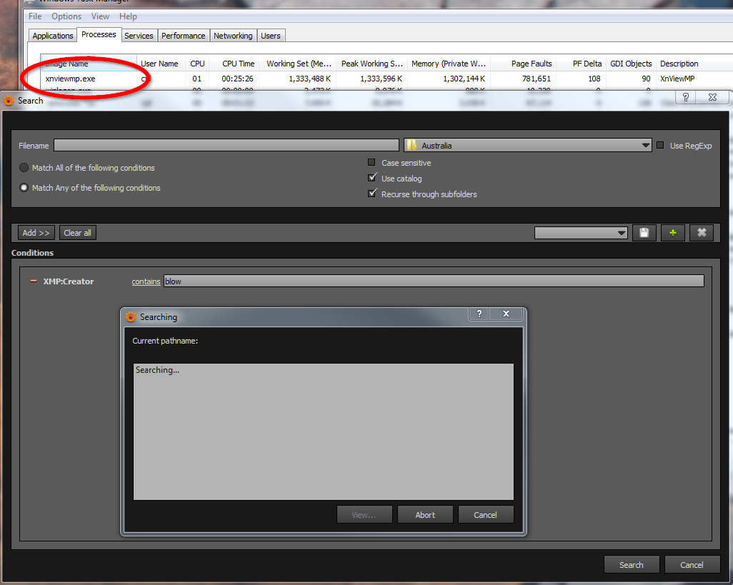

A sample file? no. This is searching a folder hierarchy. There are now 44k images in 930 folders.xnview wrote:could you send me sample file for the search? and a screenshot of the search dialog?CameronD wrote:version 0.84 - problem seems to be about the same.
Last night I selected the folder, and did view->update catalog from files just to make sure everything was correctly catalogued.
I repeated the tests this morning.
I used various search strings that gave results between zero and 200 matches - this does not noticeably change the main memory leak.
- right click on the required folder in the folder window. select search.
- search,
- filename blank,
- match ANY,
- case sensitive: no;
- use catalog: yes;
- recurse: yes
- Add single condition an XMP:Description-> contains -> the search word (or fragment)
- search then takes about 8 minutes, with much thrashing of disc and paging rates between 100 and 1000 per second
- the count of matching files is returned. (the correct matches seem to be found)
- the current and peak working sets have increased by somewhere between 250 and 300 MB.
- cancel search windows back to main screen and search again.
- repeating with the same conditions, or any other XMP condition does not seem to matter. It always results in another increment of 200 to 300 MB in each of the memory allocation numbers
- other searches based on IPTC or EXIF strings can be interposed, and memory allocation at the end of the search returns to what it was at the start of the search.
A screen shot is attached:
