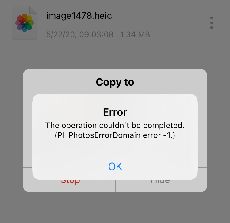

When trying to load 1477.heic into my iPhone, it accepts it.
When trying to load 1478.heic into my iPhone, it rejects it with the error message:
"The operation couldn't be completed."
"(PHPhotosErrorDomain error -1.)"
See attached screenshot.
UPDATE: I can confirm that when using GIMP (both under Linux and Windows) to convert the 1478.jpg to HEIC, it works as expected, and my iPhone can properly import/read the HEIC image.
