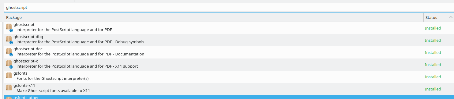

I can't open pdf files on Kubuntu 20.04 using XnView MP Linux Version 0.97.1 64bits. Error pops-up, "File can't be loaded!". The image shows the Ghostscript packages I have installed. Image files open OK.

please install a newer version of GS

Thanks for getting back. I already have 9.5 installed and like to stay current with what's in Kubuntu's Discover. Hopefully XNview will start working when GS updates.
