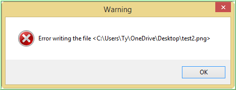

I just downloaded XnView/Win version 2.33 and immediately had a problem that I've never seen before--and I've been using XnView a long time.
When trying to save a newly-scanned image as a .PNG file, I get the message "Error writing the file <C:\Users\OneDrive\Desktop\test3.png>"
I can save as JPG okay.
I can open an existing image and save it as PNG okay.
I've attached the actual Windows (8.1, 64-bit) error message, and would be happy to do some more research if you want to suggest something.
But I have never had any any trouble saving a PNG image under any circumstances in the past many years.

Are you able to confirm that the issue is specific to Windows 8.1?Ty wrote:When trying to save a newly-scanned image as a .PNG file, I get the message "Error writing the file <C:\Users\OneDrive\Desktop\test3.png>"

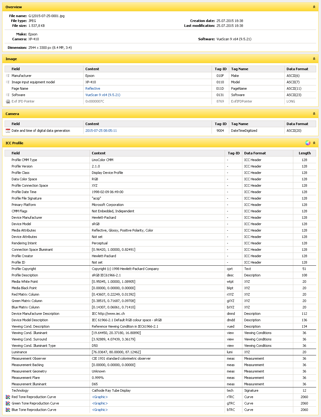

Re: Error saving PNG
Thanks for providing us with a sample, Ty.
As expected, 2015-07-25-0001.jpg uses one of those ICC profiles which are considered “incorrect” by libpng v1.6+: HP's sRGB IEC61966-2.1 (tested with Jeffrey Friedl's Image Metadata Viewer and confirmed with PhotoME + Stuffware Photo Studio).
Recommended workaround (until we have a fix):
This will also allow the conversion of your VueScan JPEG to PNG.XnTriq ([url=http://newsgroup.xnview.com/viewtopic.php?p=123257#p123257]certain PNGs cannot be saved[/url]) wrote:XnView will resave sample.png without error, if Use ICC Embedded Profile (JPEG/TIFF) - Very slow (Tools » Options... » General » ICC) is activated.

I run into the same problem (“Error writing the file”) if Use ICC Embedded Profile (JPEG/TIFF) is deactivated and I try to save layers (Tools » Multipage file » Extract All Into...) from a color-managed PSD (sRGB IEC61966-2.1) in PNG format.
xnview.ini for v2.33:
[Cache]
IsActive=0
SavingMode=1
[Start]
ParamsSavingMode=1
SavingMode=1Glenn Randers-Pehrson ([url=http://www.stackoverflow.com/questions/30709056#30710304]libpng warning: iCCP: Not recognizing known sRGB profile that has been edited[/url]) wrote:As the warnings say, you have a bunch of PNG files with invalid color profiles. Libpng16 issues warnings about them. Your application treats warnings as errors.
To work around this, you can do one or more of the following:
- Use a PNG editor to remove the iCCP chunk from the PNG files listed in the error report, e.g., with ImageMagick's "convert -define png:exclude-chunk=iCCP,zCCP"
- Use a PNG editor to remove all ancillary chunks, e.g., convert -strip
- Downgrade your libpng to version 1.5.x (currently libpng-1.5.23)
- Reinstall libpng-1.6.x (currently libpng-1.6.17) with "-DPNG_sRGB_PROFILE_CHECKS=-1"
- Find out if there is a way to have your application treat warnings as warnings, not errors, and do that.
Stack Overflow (User profile for [url=http://stackoverflow.com/users/2031419]Glenn Randers-Pehrson[/url]) wrote:Coauthor of PNG spec, developer/maintainer of libpng, on development teams for ImageMagick and GraphicsMagick. Author of pngcrush. Maintains PNG support in Firefox.

LIBPNG check for old bad icc profile now. i'll skip it
