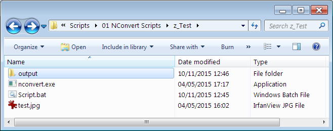

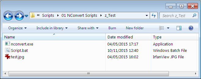

In a quick test I just set up, an output folder that didn't exist was created when the script ran, so possibly you need to back up a bit...
I ran this code:
These screenshots show the folder that was created, which contains the output file test.tiff :
I should explain that I normally run scripts as batch files .bat in a folder containing a copy of NConvert, as when I first started using the command line I found that was a simple way of ensuring the scripts ran... :wink:
