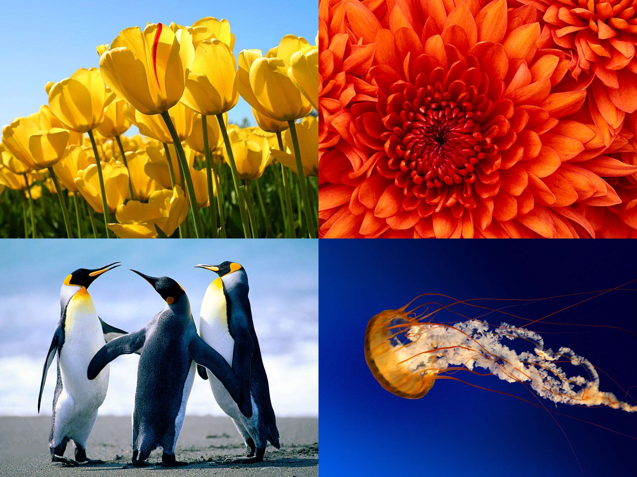

Further development with several enhancements to the above code:
First, the following line of code inserted at the start of the script allows the use of source images of any supported format, and renumbers the source files so that standard filenames can be used during further processing:
nconvert -D -out png -o Input\Image##.png Input\*.*
Second, the following additional line of code automatically creates a canvas of the required size on which to paste the source images:
Adding the additional code to the code to generate a 2x2 contact sheet in the previous post, and making some detailed changes required, gives the following code:
nconvert -D -wmflag top-left     -wmfile Input\Image01.png -out png -o a.png  Canvas.png
nconvert -D -wmflag top-right    -wmfile Input\Image02.png -out png -o b.png       a.png
nconvert -D -wmflag bottom-left  -wmfile Input\Image03.png -out png -o c.png       b.png
nconvert -D -wmflag bottom-right -wmfile Input\Image04.png -out png -o Result.png  c.png
The above code should be regarded as outline code in which the file formats can be changed and to which compression can be added as required; the code above uses the lossless PNG format without compression, and as a result the contact sheet generated has a large filesize.
Similar code with minor adjustments if required can be incorporated into scripts for other possible contact sheet layouts.
Here is a 2x2 contact sheet created from four Microsoft images using the above code:
Note: The posted image has been converted to JPEG format so that the size is below the forum attachment limit.
So NConvert can be used without too much difficulty to create contact sheets... :D
