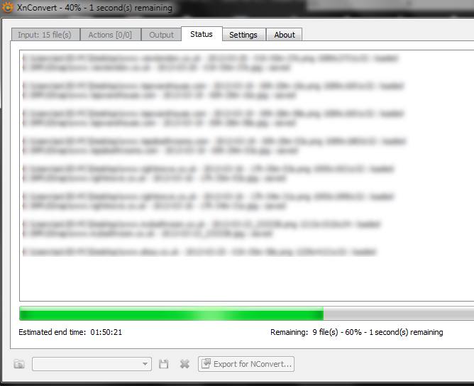

A Progress bar would be better (like in XnConvert)
The progress bar could appear in XnViewMP's status bar

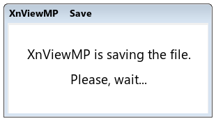

for View mode it should just appear on the status bar during saving of images (especially larger file-size images)
a very small one, native UI, like this:

Actually, I do not expect the detail of progress such as 10%, 15%, 20% and so on, the name of image, etc.
I just want to see a simple indicator such as a small pop-up window. That is all.
After it disappears, I can confidently make the next action such go to the next image, or even do cropping again (after saving the first session of cropping), etc.
Please, note that I (perhaps, some other users too) like using full screen while doing the cropping. I have set the keyboard buttons for my own purpose, such "a, c, s" for "Select All, Crop, Save", respectively.
When XnViewMP is in full-screen mode, users may hide the title-bar and status-bar.
Is it technically complicated to make a small window (saying "Saving") appear during the save process?
Or, XnViewMP displays its small internal-image during the save process. So, this 'indicator' is the same for any OS.
With this kind of small-image pop-up as the indicator, we can expect another option such as "Use Simple Indicators" for any process that triggers an indicator such as "Rebuilding Thumbnails", etc. Again, please note that users may hide the Status-Bar.
