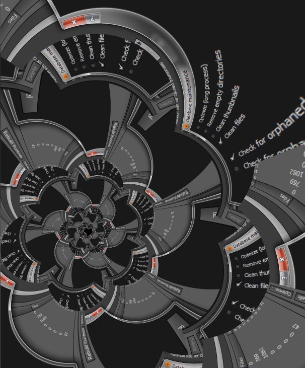

Droste effect GUI. Cooool:
An "Optimize..." button which opens a dialog with an "Optimize" checkbox?

PS: Very cool, this Droste recursive effect.
