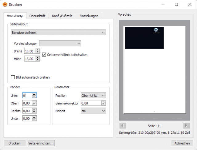

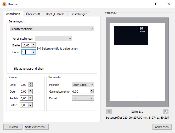

when I open the printing dialog there are always margins, allthough no margins are set by default:

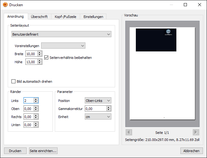

Now when I set the left margin to 2 the upper margin nearly disappears:

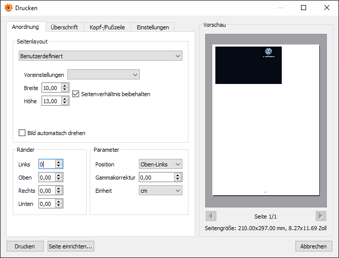

Changing the value for left margin back to 0 does also not remove the left margin completely:

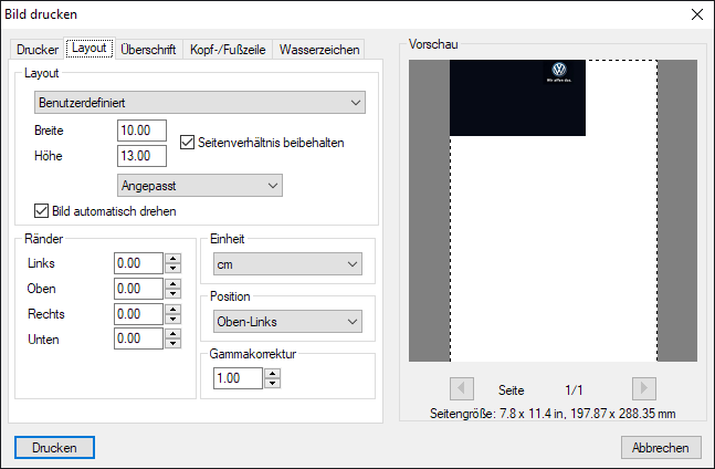

I did not have this problem with XnView Classic:
