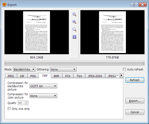

At a quick look it seems as if the colour compression setting selected is being used for black and white images:
Expected size for CCITT G4 compression = 67KB.
Test image:
