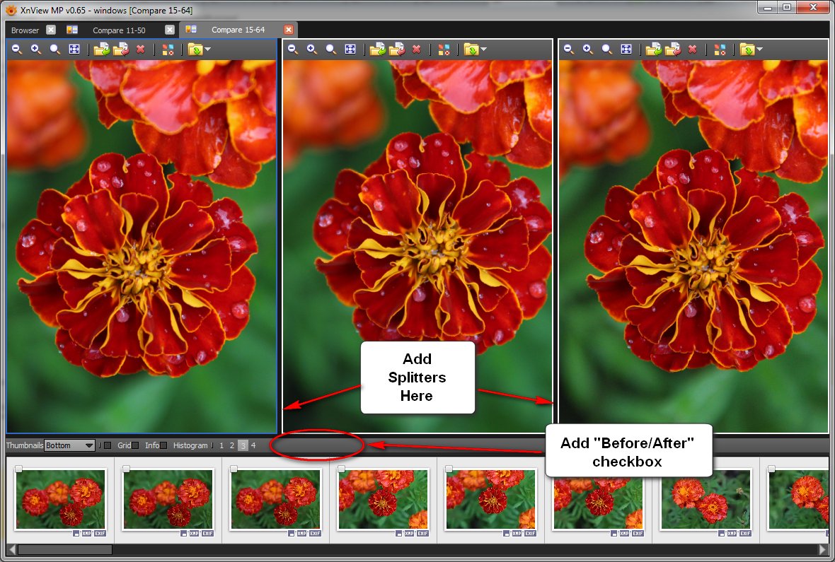

This is more easier to implement than one thinks - at least till a more-than-usable level:
1. Add splitters between the views in the Compare window (or if is easier for Pierre to work with headers, I have no problem)
2. Add a "Before/After" check box. (The caption text for this checkbox is subject to change)
Something like this (screenshot presented for 3 images - the same applies for 2 or 4 images):
If the check box is unchecked the splitters will work normally - thing which, by itself, is a good feature.
If the check box is checked then in the splitterMoved signal, find the distance on which the splitter was moved and substract it from the offset of the image from the view on the right part of the splitter in order to give the effect that the image from the right "stays" on screen.
I think that this "Before/After" feature together with "Use tabs" will enhance a lot the comparing experience without too much coding from Pierre's part.

Yeah, ok. Let me explain what the guys want (and I subscribe too).
First, to explain what we have:
We have a Compare window in which we can see side by side the photos img1, img2, img3 and img4 in order to choose the best one.
Ok, this is all fine. Now, let's add a small enhancement: a vertical splitter between each two views. Yeah, this is nice sometimes - one wants to see more from a photo or from another.
But what happens with a splitter?
Because the photos has the LeftX and the TopY coordinates static when the user move the splitter the 2nd image 'slides' with the splitter - it is the normal effect everywhere.
However, in most of the cases (usually) the img1 and img2 have a strong connection between them:
- the img1 is the image BEFORE processing and img2 is the image AFTER processing
AND/OR
- the img1 and the img2 are consecutive images from a series of shots (burst or not) of the same subject.
For both very common scenarios from above the splitter should optionally behave like this:
http://www.catchmyfame.com/catchmyfame- ... er-plugin/
(move the splitter in the middle of photos to see the effect)
In fact the only code needed is the one which will make the second photo 'static' - IOW substract from the 2nd photo's LeftX the SplitterX distance on which splitter is moved (distance positive to right, negative to left). In fact at the link above there is the source code in JavaScript on how to do it. As always, the programmer needs to be attentive at bounds, margins etc. :)
m. Th.

Pierre, it's a tool. For us.
Is not a critical exam in order to see that you can cover all the situations. :)
Let's define x1, x2, x3, x4 the left coordinates of each photo. In the same way, let's have the y1, y2, y3, y4 for top coordinates.
Also, let's define the d1, d2, d3, d4 the moving distances (if exist) for each splitter (if exist).
Let's start with the simple, known case:
What do we must add for 2 photos?
In the splitter's AfterMove signal (or in a similar place) we must 'simulate' that the next photo (img2) is staying. Hence: x2 := x2-d1; That's all.
In the case of 3 photos what we have?
If the 1st vertical splitter is moving we must 'simulate' that the next photo (img2) is staying. Hence: x2 := x2-d1;
If the 2st vertical splitter is moving we must 'simulate' that the next photo (img3) is staying. Hence: x3 := x3-d2;
The key word here is "next" - you must act only on the 'next' photo: the "next" photo is the photo at the right of the splitter.
In the case of 4 photos:
Let's say that we have the images like this:
img1 | img2
img3 | img4
You have some paths:
1. I would put in the form/tab only 2 (two) vertical splitters and one horizontal splitter. The vertical splitters will work like above (one on the img2: x2 := x2 - d2; and one on img4: x4 := x4 - d4). The horizontal one will be a 'classical' one, no code required.
2. Again, 2 vertical splitters and one horizontal splitter. The vertical splitters work like above. The horizontal splitter will work on BOTH images at bottom: y3 := y3 - d3; AND y4 := y4 - d3; (d3 in both formulas since we have a single horizontal splitter)
3. Implement a quad splitter, like this one: https://qt-project.org/forums/viewthread/7308
The formulas will be the same. The quad splitter acts on img2, img3 and img4:
x2 := x2 - d2; x4 := x4 - d2; (the horizontal distance is the same for both photos)
y3 := y3 - d3; y4 := y4 - d3; (the vertical distance is the same for both photos)
m. Th.
