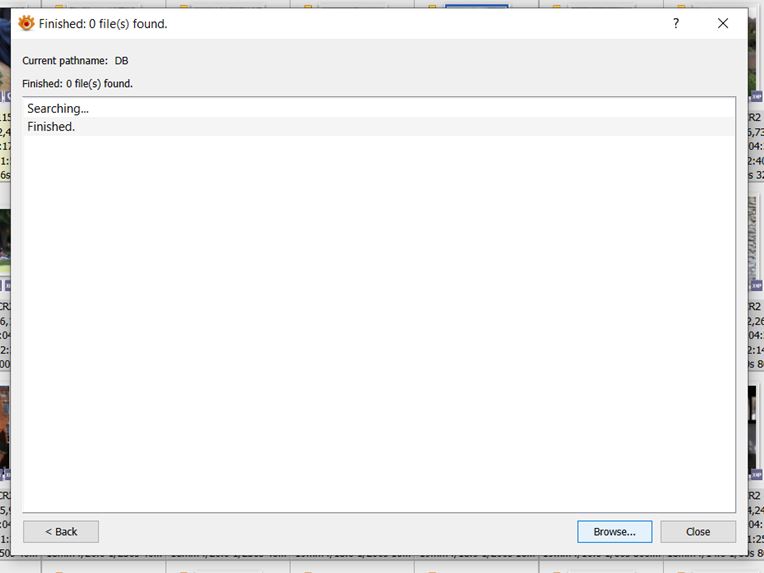

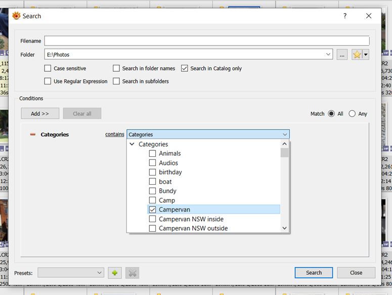

In the Search box
Folder field = E:\Photos (which is where all my photos are)
Search in catalog only – checked
Under Conditions I have added Categories and selected Campervan (I know there are 50 photos with this tag)
Match All is selected
But search does not return any results
See attached; Search 1 and 2

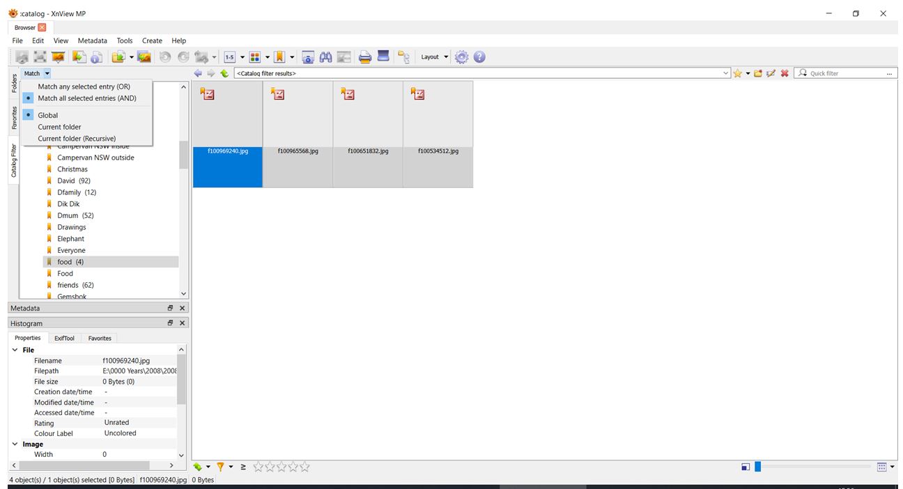

Using the Catalog filter:
AND and GLOBAL are selected.

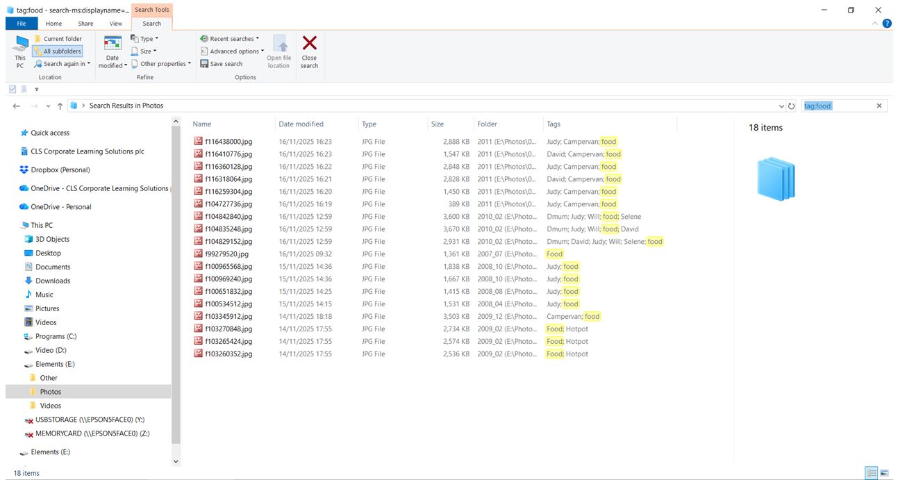

Selecting category food. Only 4 photos are found but there are 18 with the food tag. The ones that are shown have no metadata but all 18 do have metadata.

In the Search box

Try turning off search in catalog only; it will be slower. If it finds the files then, your files were tagged externally and the database in XnViewMP has not been updated.
Turn on search in subfolders if your files are in subfolders.
If you've been tagging files in other software, go to Settings:Metadata and ensure the options are set correctly. Turn on the import options there, and the categories options.
You may then have to select the files and do an update metadata from files.
