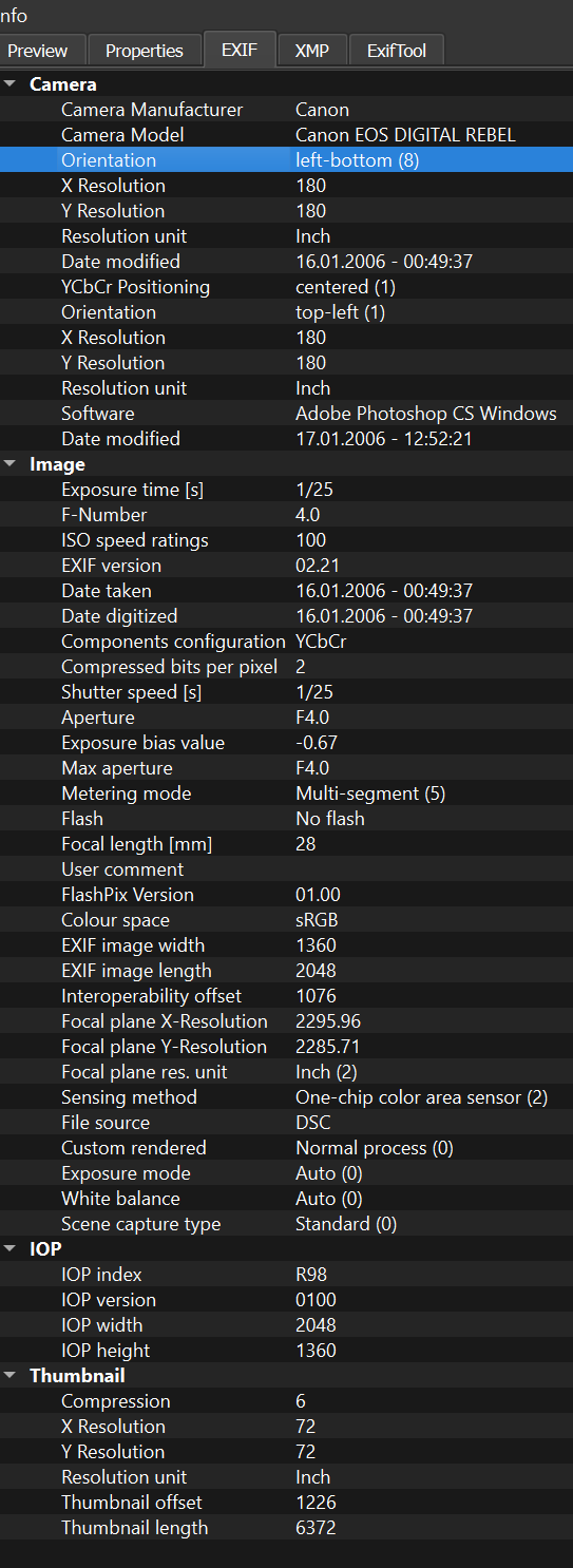

I also have found this "Orientation" in EXIF, but as well, no way to search for it.

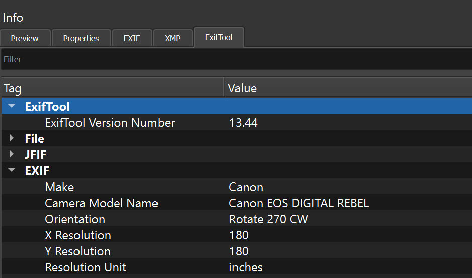

Thank you for your patience!
I did not knew know that ExifTool is an external tool too. It showed up here as a tab so I was under the impression, that's the tab you've meant.
I now have downloaded it and set the correct path in xnview and now it shows more info and also a version number in the same tab.
(I also read the FAQ: I did not replaced the ExifTool that comes with xnview, but stored it in a path that xnview can access)
So that seems to be up and running.

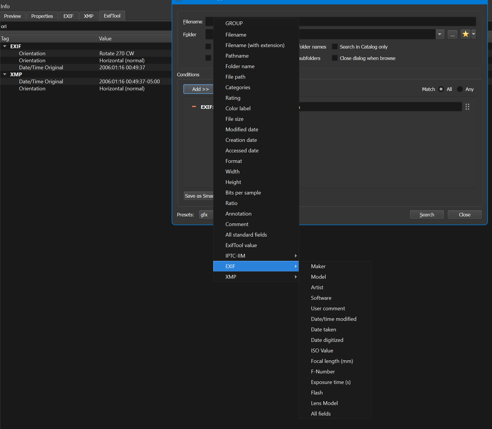

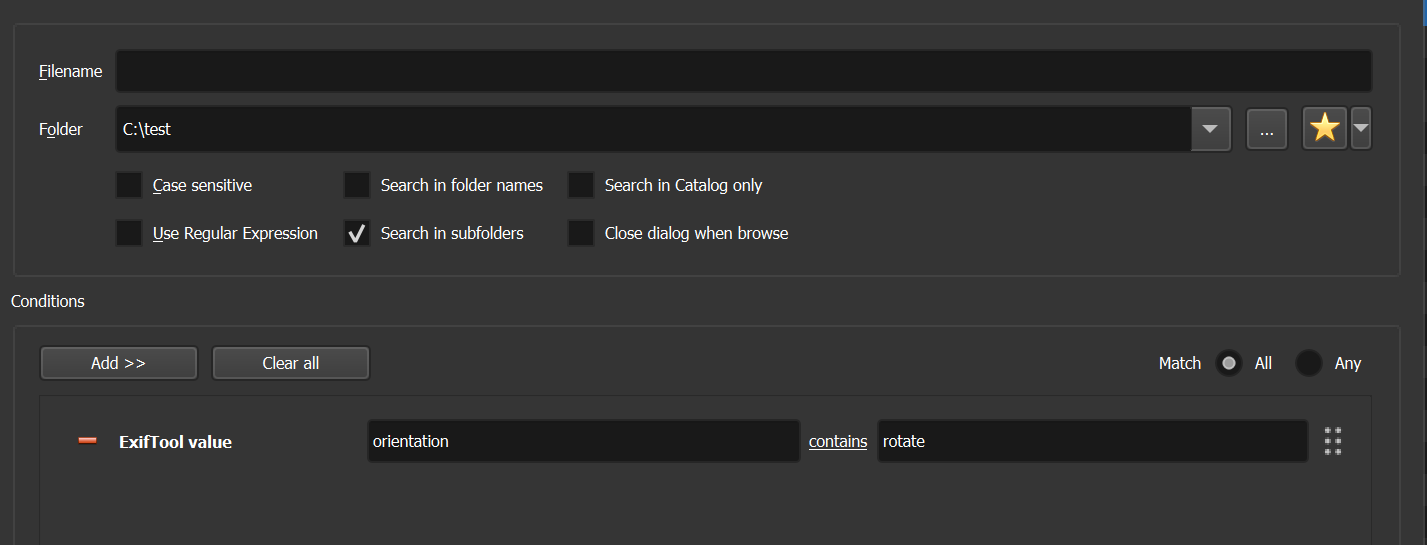

This is an example of how I search: I'm not using a Catalog.
So I tried to check if ExifTool is giving any results, but no.
When I use this seach, I don't get results: When I use this seach, I get results:

What is not working, is the same as I wrote in my last EDIT:
neither "orientation" or "Orientation" or "EXIF:Orientation" or "Rotate" or "CW" or "270" did find anything. "Finished 0 file(s) found."
