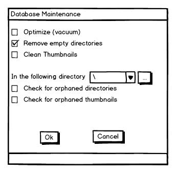

Also, you have there an "Optimize" button. When one clicks on it, instead of doing your present code it will open a form like this:
When one presses the "Ok", the program will execute the checked maintenance tasks.
- 1st checkbox is your old code (which I suppose that is the 'Vacuum' command)
- 2nd - remove the empty directories - folders which have 0 entries in 'Images' table. Algorithm described in my 1st post in this thread.
- 3rd - the algorithm from my first post in this thread. But (perhaps) without the 'TagsCount' field. I think that it can be done in one single SQL command, even if it will be a little bit slower, but usually, users can wait in such situations.
- 4th and 5th... surprise! :) if you're interested I can give you a hint how to do it faster.
Everything is clearer now?
Comments?
Suggestions?
m. Th.
Currently optimize check for orphaned files (check file system + vacuum)
ok
So almost like 'optimize', must check file system??
Hmmm... mhmmm... mmmm... I think that's too much in one pass. :?
  • 1. There is something which is very very fast and can bring very good optimisation: Missing (orphan) File Directories Check. The scan for these is quick and delete from DB is also very quick. And you can delete a bunch of files. Hence this is an optimisation which must be run often.
    2. Then there is something which is medium-low speed but can bring good optimisation but only if you know that there are such cases: Missing (Orphan) Files Check. The user will run this only if he knows that from existing directories are files which are deleted/moved from outside of program.
    3. And third, there is VACUUM. A slow process with a disputable (low) benefit, especially with the advent of hybrid HDDs, SDDs, HDDs with big cache (16MB or so). Perhaps is better to know that in disk storage layer the most expensive thing is aquiring space. That's why enough DB engines make from the begining big, empty files for their DBs - some of them having a quite powerful syntax for this (eg. Oracle). That's why, usually, the databases do not shrink and in order to shrink a database you must do a more complicated procedure (ie. taking the database offline + a backup/restore cycle). Also, in OLTP/data aquisition applications there's a technique in which the app when is idle or in low-stress periods of activity, fills on purpose the tables with 'empty' data in order to aquire space.
That's why I broken them in three parts: Orphan Directories Check, Orphan FIles Check and Optimize (Vacuum)
ok
For the 3rd - it seems that the 'Clean Thumbs' (somewhat) works but it isn't optimal. As I said, I will send you a special PM for this.
Yes. But, as I said above, in different phases because the user can choose to check only the directories which is much more efficient than files. Also, I put an edit there in order to enter the root path for the check. This is more important than it seems at the first sight. It has two main uses:
  • 1. To restrict the area of searching where the user knows that there it might be something to find. (Hence before start scanning the file system, is better to do a 'select pathname from folders where pathname like '+myRootFolder+'%' - beware at myRootFolder to be properly formated (with the proper \ (slash) and not /, also having a slash at the end) and search only these folders. Also, take care at the root folder to have the proper case (LIKE is case sensitive for non-ASCII characters). For this you check the existence of the folder and take from disk the actual name. Anyway, you must do this. If the root folder doesn't exist, the entire process stops.
    2. To restrict the area of searching where the user knows that there aren't pseudo-offline files. For example I have in catalog files from network. Files from external SATA disks. What if the engine will not find the files/directories because the server is offline or the disk is out and decides to delete them?
m. Th.
