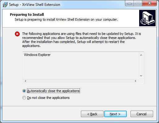

V@no
Posts: 36
Joined: Sun Feb 25, 2007 8:06 pm
Re: XnView Shell Extension
Post by V@no »
Peter2 wrote:
xnvusr wrote:Hello,
on attempting to install the shell extension, i get the following error message..
It seems that the DLL is used at this moment. Restart the computer and try to install again immediately , without using XnView-shell before.
Peter
I can't get it to install even after reboot. This is the only software of countless thousands of other software I have ever installed, that can't update itself without deep user involvement requirement.
Is this due to Inno Setup script limitations? Probably not:
restartreplace
When an existing file needs to be replaced, and it is in use (locked) by another running process, Setup will by default display an error message. This flag tells Setup to instead register the file to be replaced the next time the system is restarted (by calling MoveFileEx or by creating an entry in WININIT.INI). When this happens, the user will be prompted to restart their computer at the end of the installation process.
NOTE: This flag has no effect if the user does not have administrative privileges. Therefore, when using this flag, it is recommended that you leave the PrivilegesRequired [Setup] section directive at the default setting of admin.
But if it is, then perhaps it's time to switch the installation script all together, just because for the fact that 64bit software does not belong in C:\Program Files (x86)\ folder anyway (it seems the proposed by VictorVG fix for path on 64bit OS was ignored too)
[EDIT]
I just tested this installation script on Windows 7 x64 and it worked marvelous. Prior the test I did uninstall original XnView ShelEx.
During installation it offered proper path for the installation directory in C:\Program Files\ (no x86)
After first install no questions asked, no restart required and shell extension worked on all previously opened explorer windows
On second install it warned that it needs close windows explorer:
I selected "Do not close", it continued the installation process, attempted install XnViewShellExt64.dll 5 times and since it was locked it continued with the installation and at the end it asked if I want reboot to complete the installation. I chose not to reboot.
Third installation attempt informed me, that reboot required after previous installation and would not go any further. So I did the reboot.
After reboot I ran the installation forth time and when it asked if I want it close all programs (windows explorer), I said yes, all windows closed, setup successfully continued and no reboot required.
So this is how it supposed work. Please update your installer with this script (all credit goes to VictorVG):
