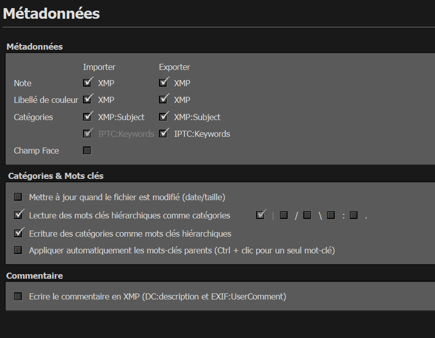

I extensively use hierarchical classification within the image itself through IPTC and XMP.
To do this, the settings are as follows:
xnview classement hierarchique.png (41.78 KiB) Viewed 1184 times

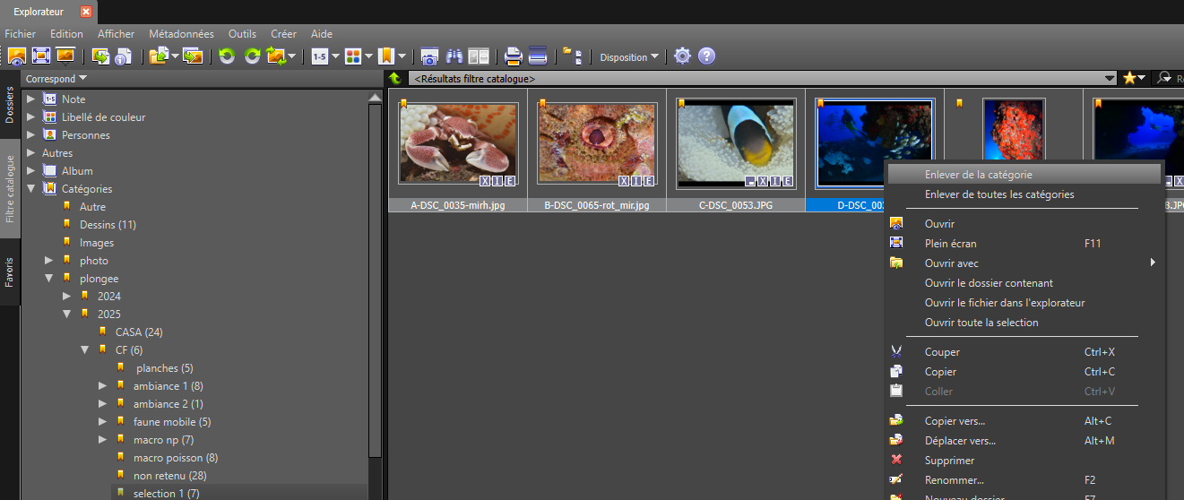

My procedure is as follows:
- I go to the relevant category using the "Catalog Filter" panel.
- I select the image, right-click, and select Remove from Category.
xnview classement hierarchique2.png (210.3 KiB) Viewed 1184 times
- Metadata > Update File from Catalog
So far, so good.
The problem occurs if you try to delete the very last category using the same procedure.
If the category you're trying to delete is the last remaining category, after deleting and updating the file, the last category remains in the IPTC keywords (not in the XMP).

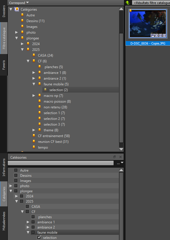

The workaround I found is to delete the category via the categories panel:
xnview classement hierarchique3.png (76.82 KiB) Viewed 1184 times
