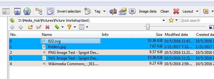

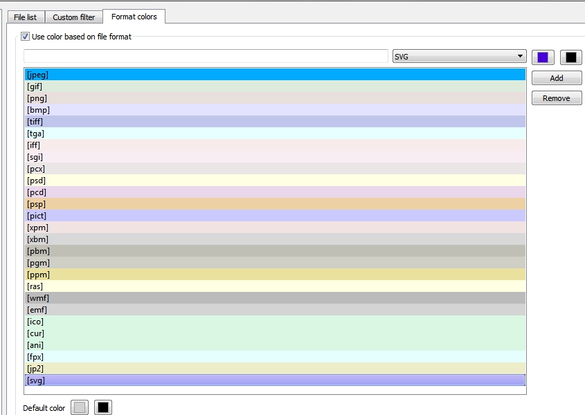

Hi:
Try this one. I used options panel to enable the format colors and .svg was already their.
I only changed its color to purple.
formatColor-0="[jpeg],0 170 255,0 0 0"
formatColor-1="[gif],220 235 220,0 0 0"
formatColor-2="[png],232 222 220,0 0 0"
formatColor-3="[bmp],227 227 255,0 0 0"
formatColor-4="[tiff],192 197 235,0 0 0"
formatColor-5="[tga],230 255 255,0 0 0"
formatColor-6="[iff],247 235 235,0 0 0"
formatColor-7="[sgi],247 237 242,0 0 0"
formatColor-8="[pcx],235 230 230,0 0 0"
formatColor-9="[psd],255 255 227,0 0 0"
formatColor-10="[pcd],235 215 235,0 0 0"
formatColor-11="[psp],237 208 163,0 0 0"
formatColor-12="[pict],202 202 255,0 0 0"
formatColor-13="[xpm],242 227 227,0 0 0"
formatColor-14="[xbm],216 216 216,0 0 0"
formatColor-15="[pbm],191 191 182,0 0 0"
formatColor-16="[pgm],207 207 197,0 0 0"
formatColor-17="[ppm],235 225 159,0 0 0"
formatColor-18="[ras],255 255 227,0 0 0"
formatColor-19="[wmf],187 187 187,0 0 0"
formatColor-20="[emf],212 212 212,0 0 0"
formatColor-21="[ico],217 247 227,0 0 0"
formatColor-22="[cur],217 247 227,0 0 0"
formatColor-23="[ani],217 247 227,0 0 0"
formatColor-24="[fpx],229 255 255,0 0 0"
formatColor-25="[jp2],237 237 202,0 0 0"
useFormatColor=true
selectedColor=10 36 106
labelColor-0=255 85 0
labelColor-1=253 253 253
labelColor-2=230 0 0
labelBColor-0=24 24 24
labelBColor-1=85 0 0
labelBColor-2=25 25 25
formatColor-26="[svg],71 0 214,0 0 0"
Screen: 1
Screen: 2
As you can see It's using .jpeg color.
If I manually put it above .jpeg in the list, it starts working correctly until restart.
Posts: 46812
Re: 0.83: Format colors isn't working
Erixx haxx wrote: Try this one. I used options panel to enable the format colors and .svg was already their.
you need to use svg not [svg]
formatColor-26="svg,71 0 214,0 0 0"
