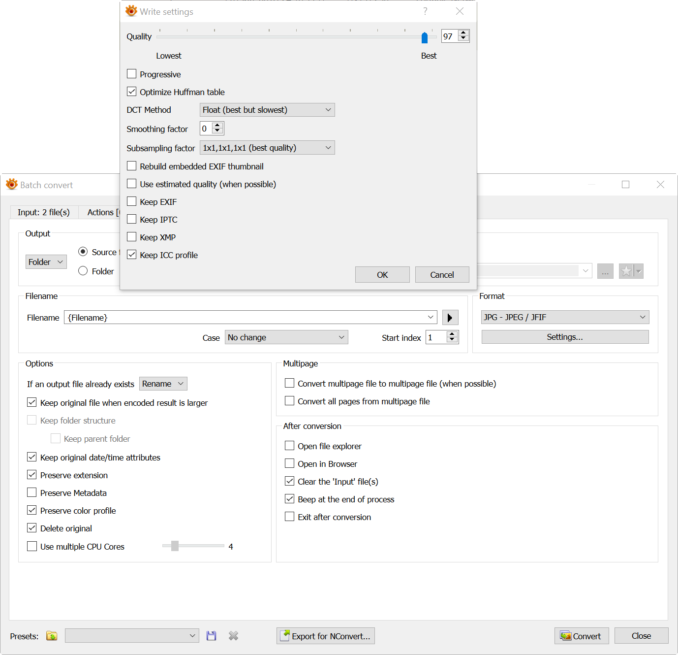

Look in the attachments.
1) Conversion to JPEG format (see screenshot)
2) "Keep original file when encoded result is larger" is ON
3) Both of these files with color profiles so my yesterdays assumption that all color profiles are affected was incorrect, or maybe partially incorrect
4) Results:
color_profile_1.jpg will get BIGGER after conversion and will be saved
color_profile_2.jpg will get SMALLER after conversion and will be saved
Funny thing - if you forcefully convert these file once in XnView then they will both go down in size on the NEXT conversion. :D
