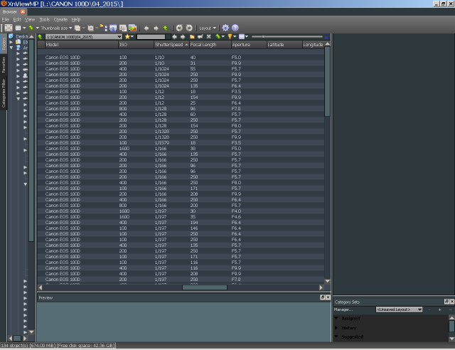

I sometimes like to sort the photos by increasing or decreasing EXIF metadata like shutterspeed or focal length but the sorting doesn't work as it should (IMO :))
For example: a picture with the focal length of 18mm will get sorted between 179 and 181 and or for shutter speed: the slow shutterspeed of 1/8s is right after the fast 1/799s while it should be between 1/7s and 1/9s.
I guess the sorting need to add a few zeros so 1/8 is interpreted as 1/0008 or 18mm = 0018mm but it shouldn't display these 0 numbers.
Thanks

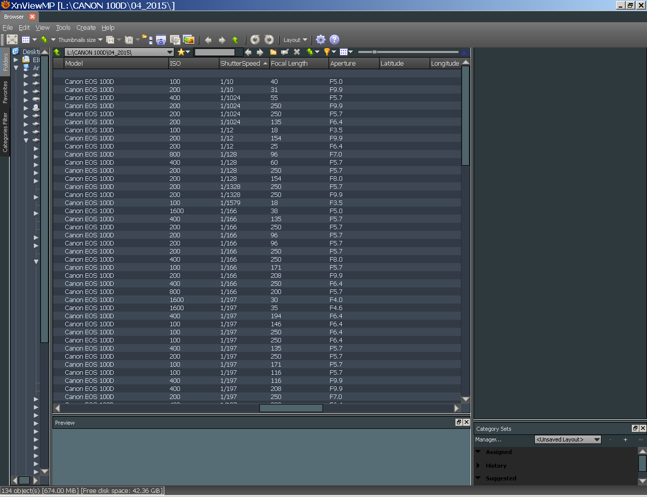

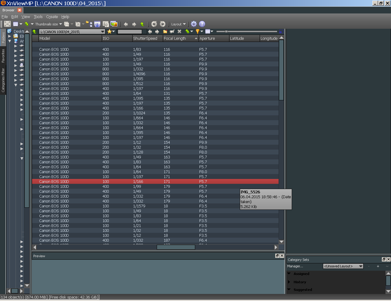

Here are two examples.
shutter speed 1/10 is much slower than 1/1024. 1/12, 1/128 etc are still slower but are sorted after the 1/1024 so the sorting is wrong.
Same goes for the pic of the focal length sorting
thanks
