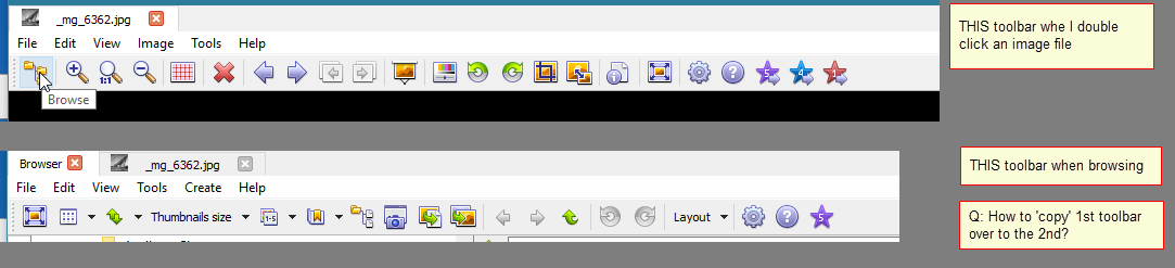

There is a difference between the toolbar after double clicking an image file (viewer toolbar?)
and the one showing up when 'browsing' (say, the Explorer like toolbar).
Is there an easy way to synchronize these toolbars, or better said, to have the browser toolbar be the same as the 'viewer-toolbar'?
Thanks!

mrwul wrote:Seems, right now, one has to configure them separately.
Not a big problem, but would have been easier to configure 1 and then something like
'set same toolbar for browser' or something like that.
But some functions are only applicable for one mode or the other, so it is only possible to synchronise them to an extent...

Go to Cusstomize toolbar and click Save button on upper right position.
Save as 'My1' for example.
Open xnViewMP directory, file 'My1.bar' will be there, open it with notepad.
You will see sections for Browse and View.
Edit as you like and save (with xnVew not running). Example - Copy all between Browse and View rows, delete everything after View and paste there.
Start xnView and you must see new toolbars, if not - open again 'customize toolbar' and click on LOAD , then select 'My1.bar'.
Don't do this if you don't know how to restore initial state in case of errors.
