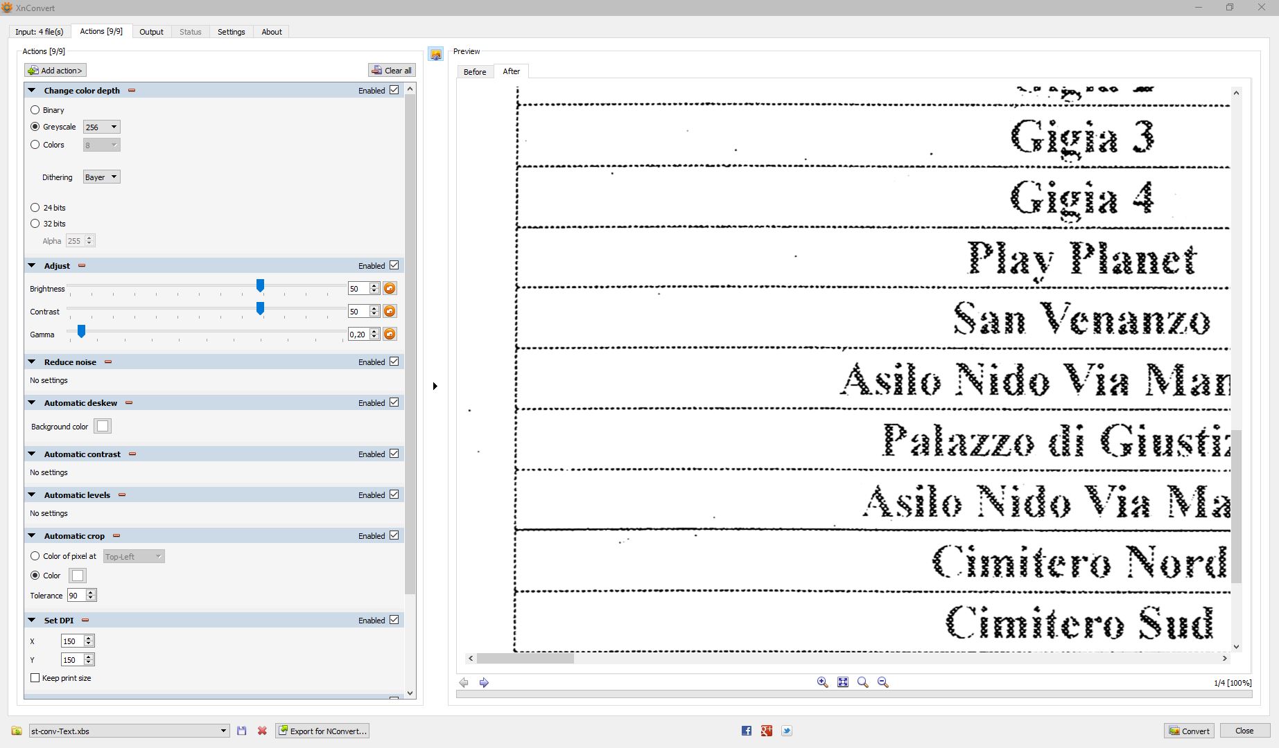

I noticed a halftone or dither pattern in your screenshot.

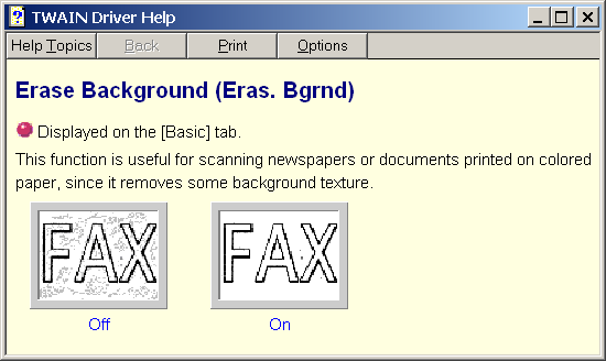

I also downloaded the TWAIN driver for the Ricoh Aficio MP 2000 and extracted the help file: In the Quality Settings, there seems to be an Erase Background option “for scanning newspapers or documents printed on colored paper, since it removes some background texture”.
Photo Pattern in Scan Settings Windows → [Details] Dialog Box → [Basic] Tab → Settings in the [Advanced] Dialog Box allows you to “specify the type of photo (dither) pattern to use when the [Col./Grad.] is set to [Binary (Photo)]. Each photo (dither) pattern has its own characteristic effect. Experiment with several to find one that fits your requirements.”

So you've set up an unattended scanning system using an automatic document feeder and your NAS, bypassing the TWAIN driver. Unfortunately, that Erase Background is done by the software and seems not to be available in the firmware.
Could you please try applying the action for removing the speckles (Reduce Noise) before dithering (Change color depth)? I believe this would yield better results.

here's my latest configuration version for XnConvert when "cleaning" scans. the greatest differences i did find in the past was moving the reduce noice below normalize EX or adjust brightness. But even then in general i did find little difference. I don't know the algorithm for "reduce noise" but seems to work best on very low res. The scans i was working on right now were about 9500x6500 originally A3 scanned pages, then auto-cropped to their borders.
