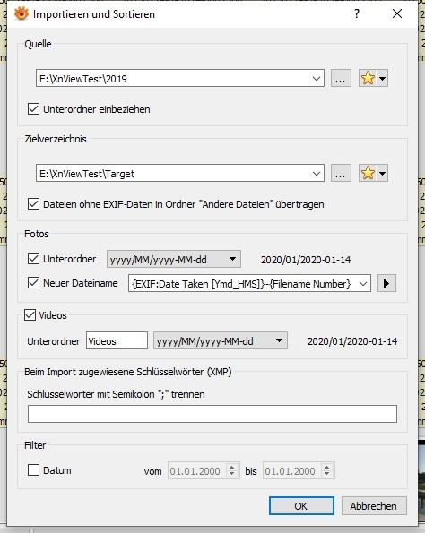

could you post a screenshot of import dialog?
Re: Options to keep filename for videos when importing

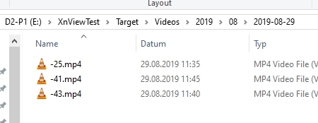

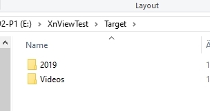

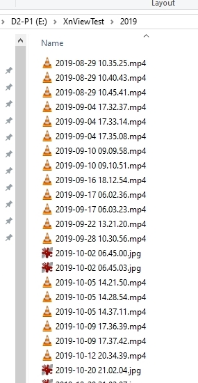

No problem.
I did a test run and double checked the options but did not find out where I made the mistakes.
As you can see, the photos are renamed in correct way but the videos seem to take the new filename pattern of the images ? Since the videos to do not have EXIF data (I suppose) they obviously just get the filenumber. But since the checkbox "Files without EXIF data ...." is checked they should be moved to the folder with "Andere Dateien" instead of the folder I gave them below.
Let me know if you need any extra info!
Thanks for your help!
Dragon013
Dragon013
hum, what is the best. if template used use EXIF, video filename must be kept?
So the option "use EXIF" is for photos and videos ?
Since there is a clear break between the section "photos" and the section "videos" I expected that it would be used separately. The field "new filename" belongs - at least in my view - clearly to photos. That is why I wondered about the change of the videos' filename.
So, I think keeping the filename of videos unchanged would be a nice option or - maybe - another, separate field for a template for renaming video files.
