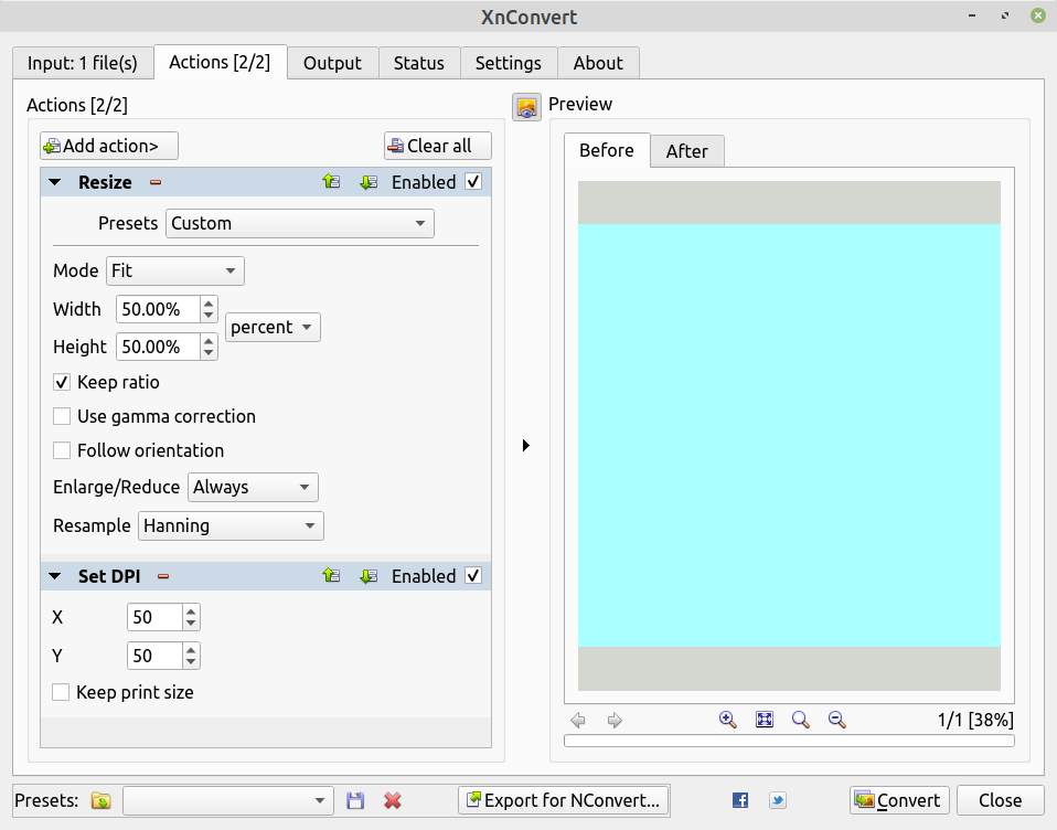

The basic method reduces the source image filesize by reducing the image pixel dimensions by a specified factor: for the Resize action, setting 50% for the height and width reduces the total number of pixels to 25% of the starting value, reducing the filesize. The original 'print' size is then restored to the starting value by using the Set DPI action to adjust the image DPI value to compensate before saving the image.

The attached 1000x1000px_100DPI PNG file can be substantially reduced in size using the above resize value of 50% for the image height and width, without changing the print size if the DPI value is adjusted to 50 DPI, and the resulting image is saved with the same compression options as the original file, see the file properties. The attached file has a print six of 10"x10" to make it easy to test.

XnConvert settings to reduce filesize of attached  1000x1000px_100DPI.png file.
