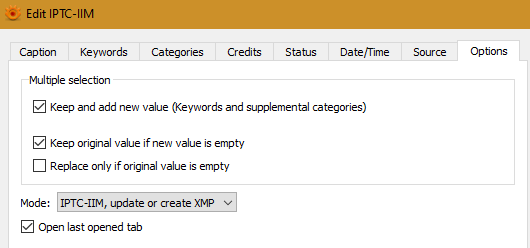

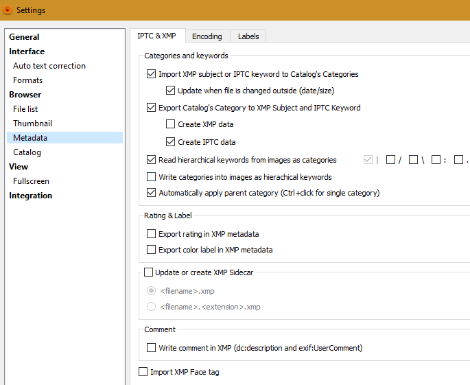

I am testing with only 1 folder with 2 files in it. Please see attached my "tools-->settings-->metadata"
as well as my "tools-->metadata--->edit IPTC" settings

With these preparations, I choose 2 pictures and go to "view-->update files from catalog"...
And it happens.... nothing. Exactly, nothing. But, when I change a category or add a tick-mark, the files do get updated.
What am I doing wrong? How can I make an export of the internal catalog to IPTC keywords?

The parameters you show seem to be correct.
Strange behaviour !

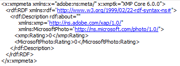

- Add "Update or create xmp sidecar" and see if a xmp file is created, and if it contains data ?
Yes, they get created, but with "nothing in there" - at least no added data.
