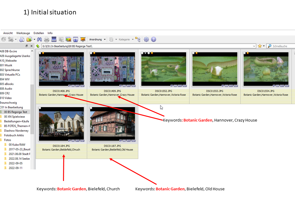

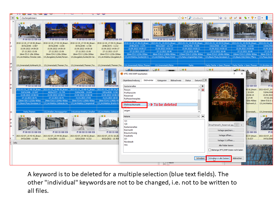

Is there a solution for the following situations in XnViewMP or in XNView?
a) Out of 100 images, 50 have the wrong keyword.
The 50 images with the wrong keywords are selected (multiple selection). How to delete a certain keyword from all selected images without writing all other keywords in all images?
b) 50 of 100 images are missing a keyword.
The 50 images with the missing keywords are selected (multiple selection).
How to write a certain keyword in all selected images without writing all other keywords in all images?
delete/add keyword to multiple selection

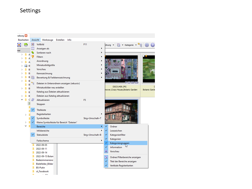

Re: delete/add keyword to multiple selection
You should be able to do this with 'Category Sets'.
To view Category Sets go to View->Panels and enable 'Category Sets'.
If you select multiple files and check the Category Sets panel then you will see that the categories that are assigned to all selected files are bold and if you select it, it will be de-assigned from all selected files. The other categories will stay in place.

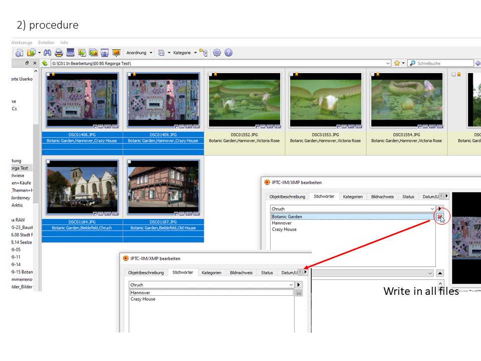

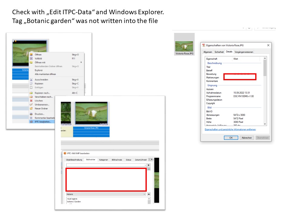

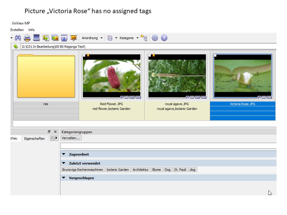

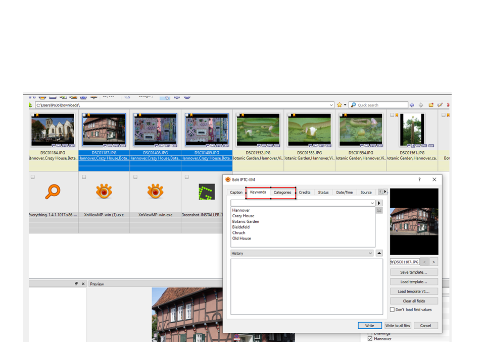

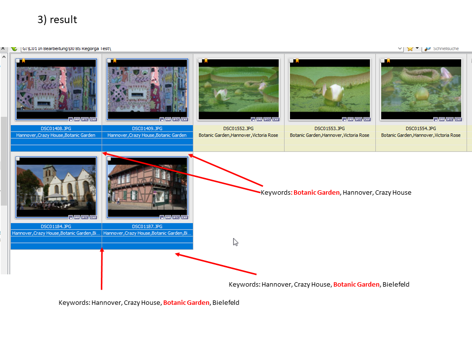

BSPicture
- Posts: 16
- Joined: Fri Apr 15, 2022 10:56 am
does not work unfortunately or I have misunderstood.
Here are the settings:

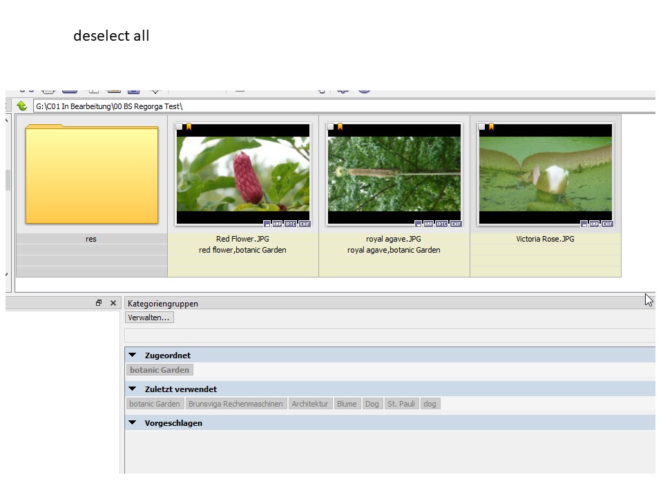

Initial situation. The keyword hightlighted in red is to be deleted
I marked the images with the wrong keywords and removed the wrong keyword. Then I saved the change with "Write to all files".
The keyword to delete was kept and the other keywords were written to all files.
So exactly what I did not want
What did I do wrong?

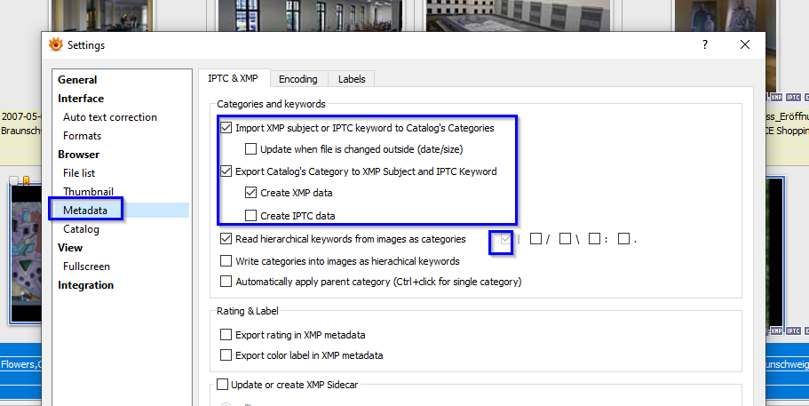

Sorry, I'm lost. I dont know which menue is meant with "Bring up the "Categories" panel, or "Category Set" as jadO said and work in one of those panels" resp. how to get there.

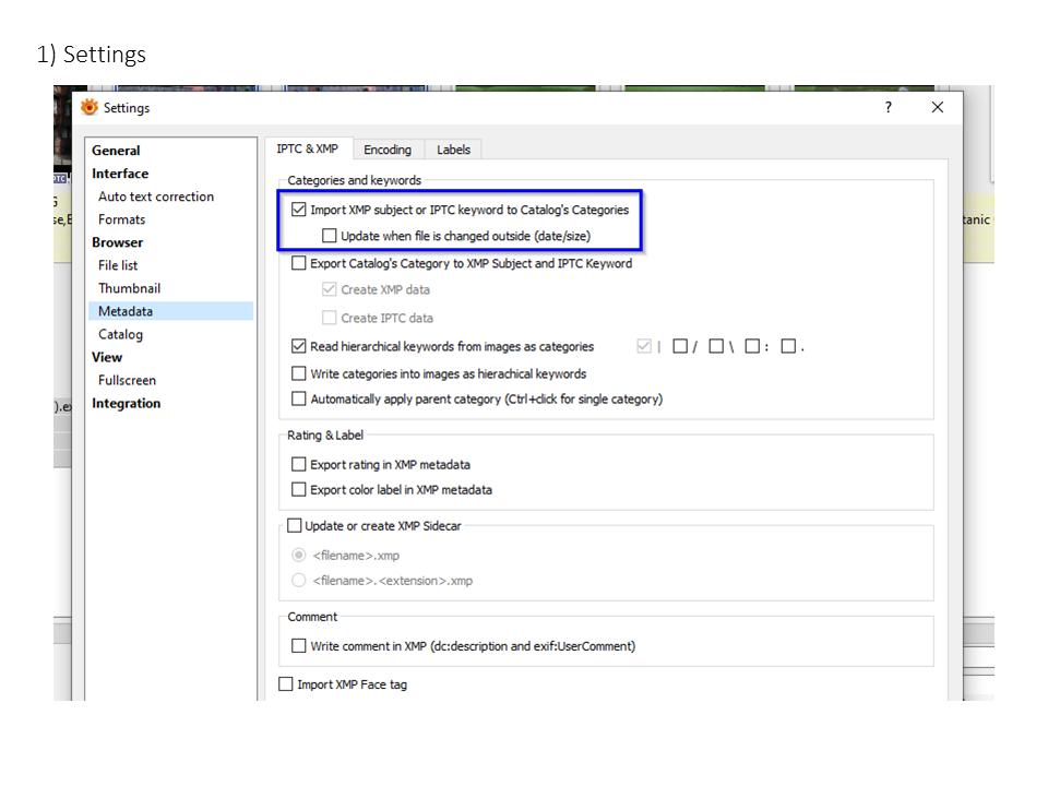

My setting for metadata
Then there are two "Categories" panels.
This one - already shown in my previous post. But here I cant "deselect the images" before saving.
And then this one... but I thinks this one is not meant
Am I in the wrong category menue?

- Posts: 1574
Sorry " ... if they were not already displayed"Bring up the "Categories" panel, or "Category Set"
But I can guess "Categories " pane at the bottom of this screenshot
( Displayed panes are set with "View > Panels " menu ... )
For "Category set", look for small tabs on the edge of an area (maybe categories area)
There are two ways to enter keywords :
1) "Edit IPTC" window ... I think this method is not convenient, and does not take advantage of the "Categories" tool
(Here the "Categories" tab is a remnant of the old "IPTC categories" that almost nobody uses anymore ; nothing to do with XnViewMP's "Catégories" tool )
2) Use categories.
First, the catalog must be up to date with keywords that are in iptc or xmp fields of your photos.
It's different, and requires a little learning, but then it's easy to change some keywords, and use "Catégories filter" to find any combination of keywords. (But don't forget to take into account the "export" and "import" options)
It is much faster to enter thousands of keywords this way, with the "Categories" panel or "Category sets"
"Work" in the categories pane means only : check a box to add corresponding keyword. (in selected photos)
Or remove checkmark to remove the keyword.

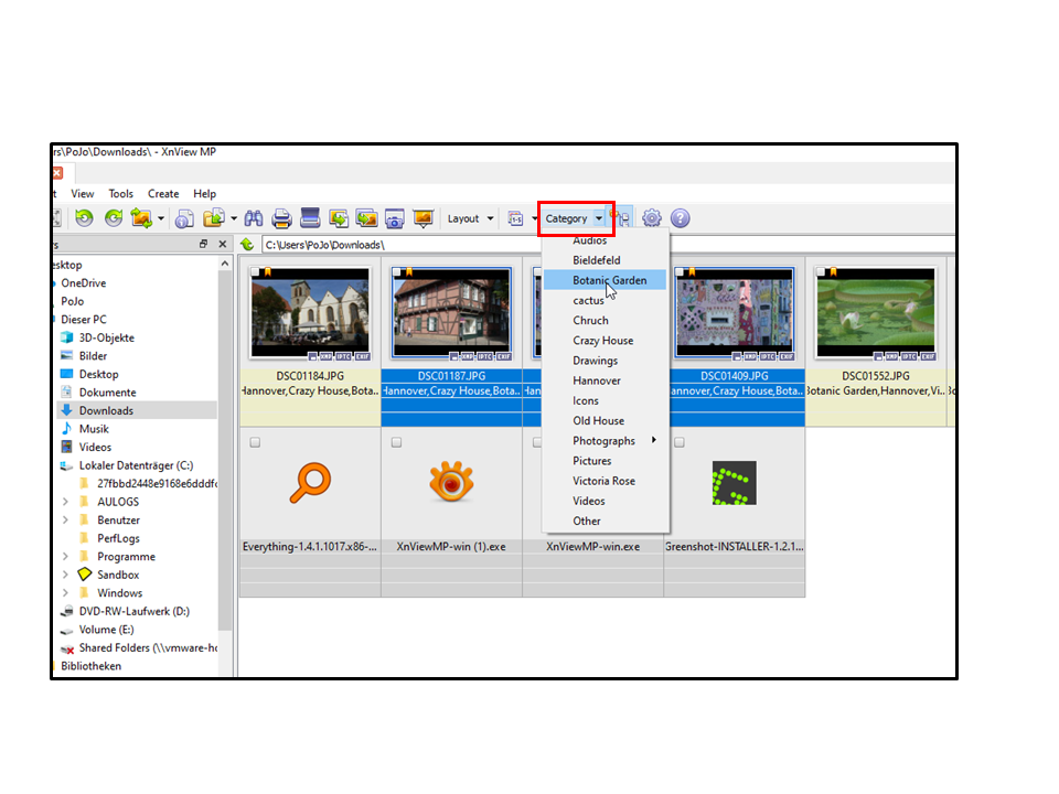

BSPicture
- Posts: 16

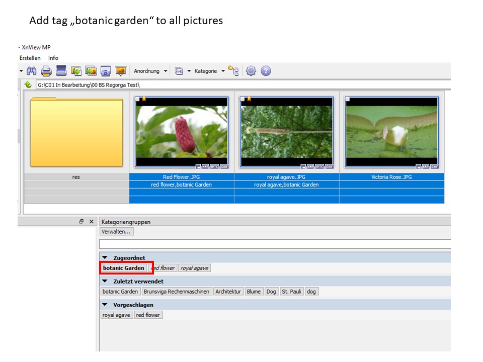

First of all, thank you for the quick reply and the patience to explain the process to me.

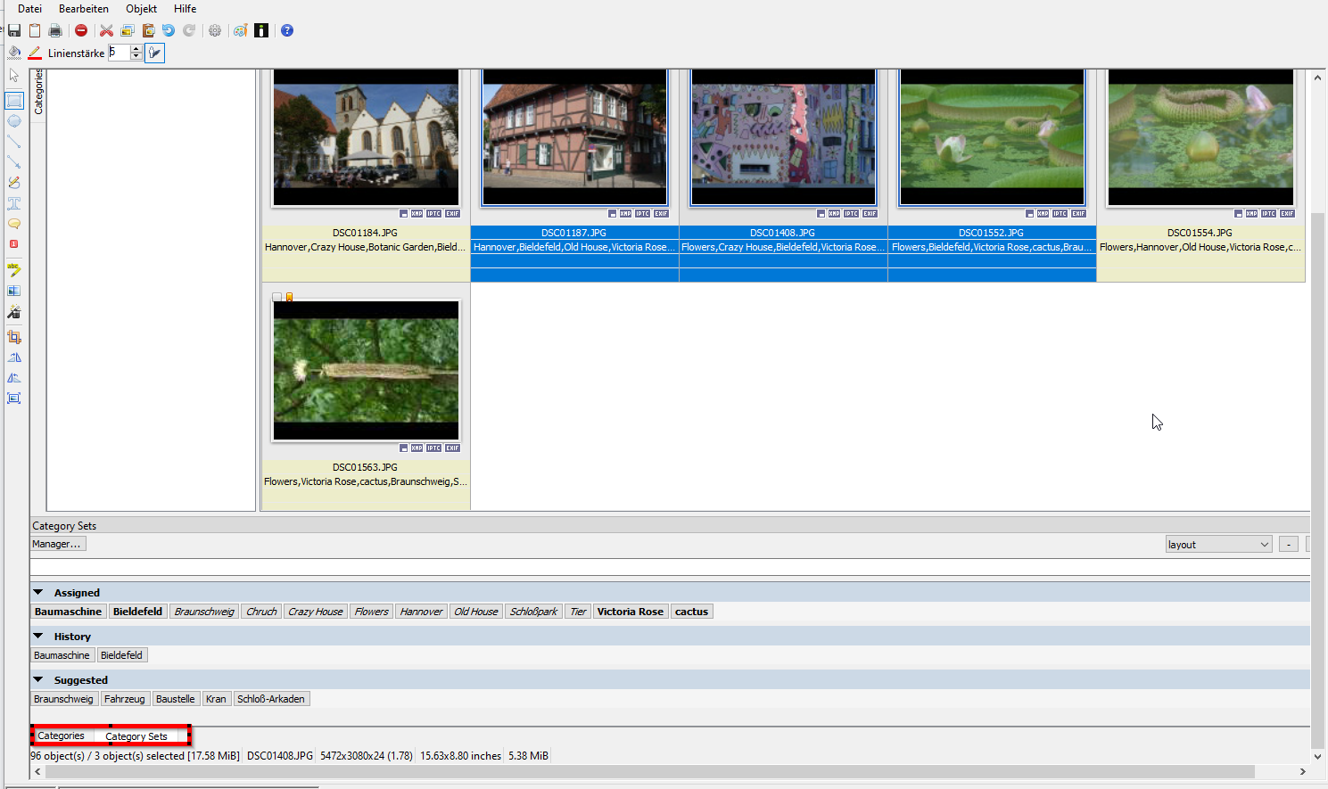

I finally found the "Set of categories/categories" thanks to the hint that the tabs are at the bottom of the screen. That was hidden for me by the taskbar
As far as I understand so far, under "assigned" are all the tags that are assigned to the selected images. Bold are the tags that are included in all selected images.
By clicking on a tag in "assigned" you can remove a tag, if you click on a tag in "history" it will be added again.
It is still unclear to me how to write the changes to the image files. I would have expected a button like "Write to all files" or "Apply". How do you apply the changes to the selected files?
Are there any instructions for this? Unfortunately I didn't find anything in the wiki or in the Youtube videos.
Here are the import settings - I hope these are the right ones
Categorie-set
Categorie-set

BSPicture
- Posts: 16

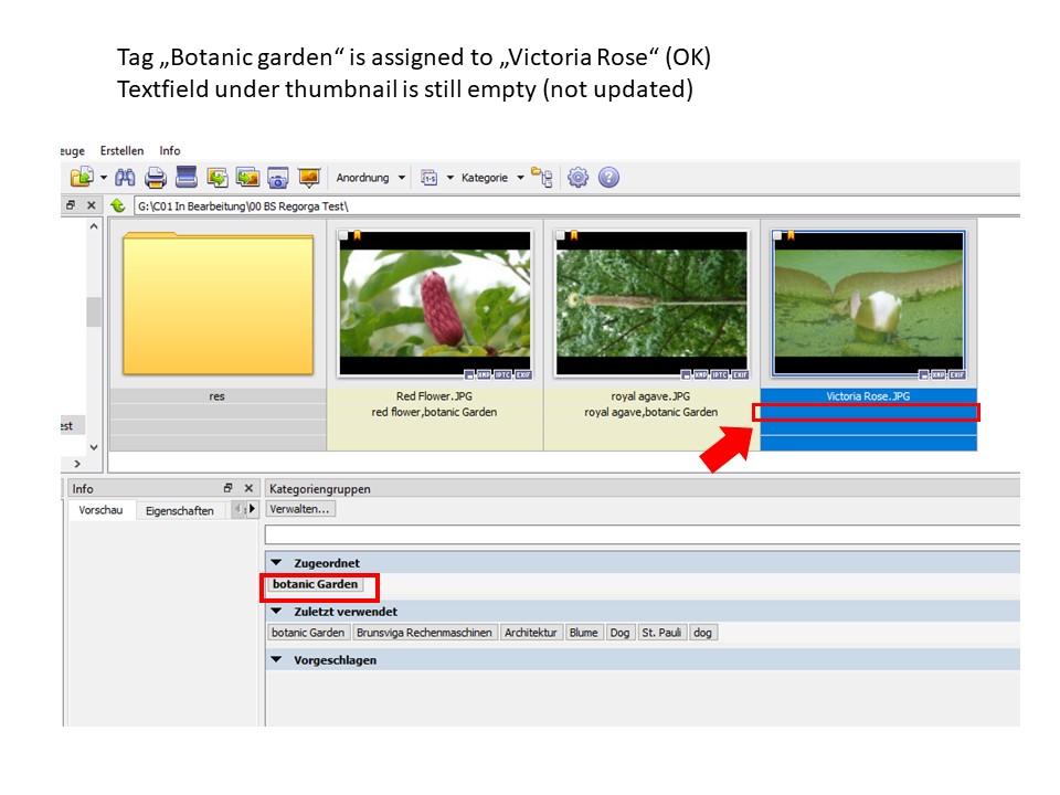

It looks like you never sleep and are always active in the forum
The 3rd step you described ("The third step does write keywords according to export settings (iptc or xmp keywords)") does not work for me - or I misunderstood it.
After deselecting, the keywords under "assigned" are updated, but the tags are not written into the file itself.
Should the changed tags be written directly to the files or is an export file created with the updated tags?
Here is the process as I understand it so far

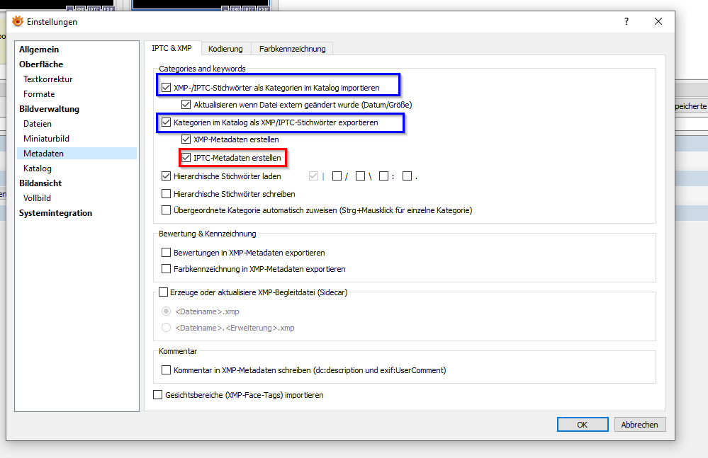

BSPicture
- Posts: 16
I checked the export settings for the metadata right after your first post. The corresponding import/export checkmarks were already set there.
BUT: After your last post I checked the settings again and I noticed that there is an option "Create IPTC-data" in the export settings. This was disabled.
I have now activated it and now the IPTC data are also written into the files.
Thanks to you and michel038 for the support
