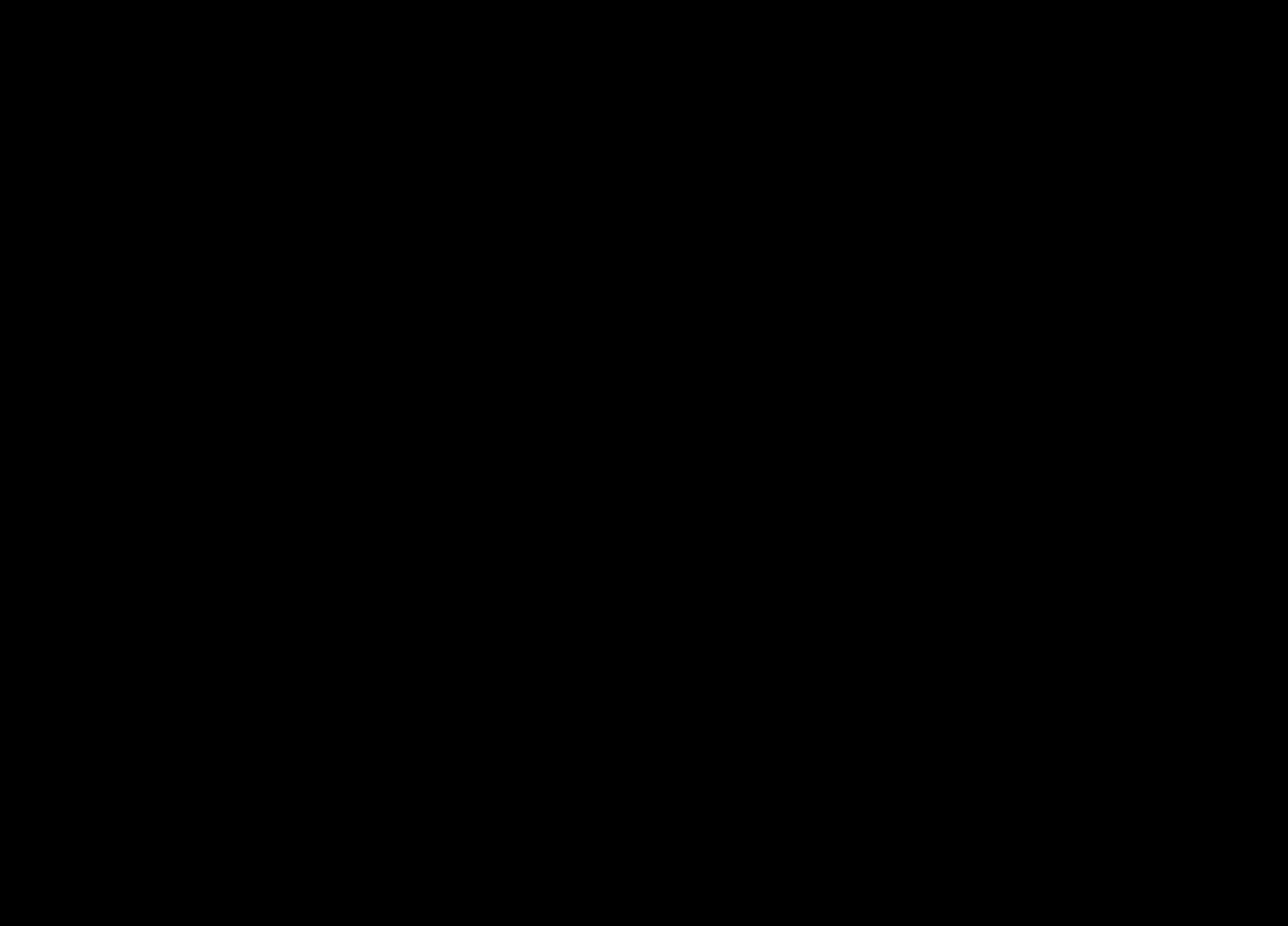

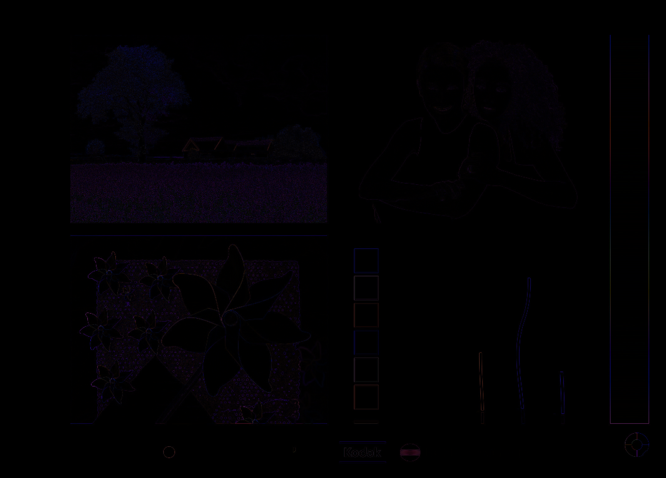

The big bug with xnviewmp's heic encoding is that the encoding quality
doesn't match the option slider's setting.
If you use the max value (100 (= "lossless") and compare that to the
heic file that GIMP produces with its max value,
you see that xnview's file size is much smaller than GIMP's
and that the resulting quality is very poor compared to GIMP's.
This means that your encoder is very poor even with its max settings,
or that there is a bug in using the encoder.
If you can't help that, the best thing would be to do something
like a "half slider" (max value = "50"), and tag 50 as "still not good"
or something like that.
To my opinion.
I attach the two arithmetical differences from the original 24bit image
to a heic file encoded by XnViewMP and a heic file encoded by GIMP.
If you split the files to HSV channels you see the BIG difference.
