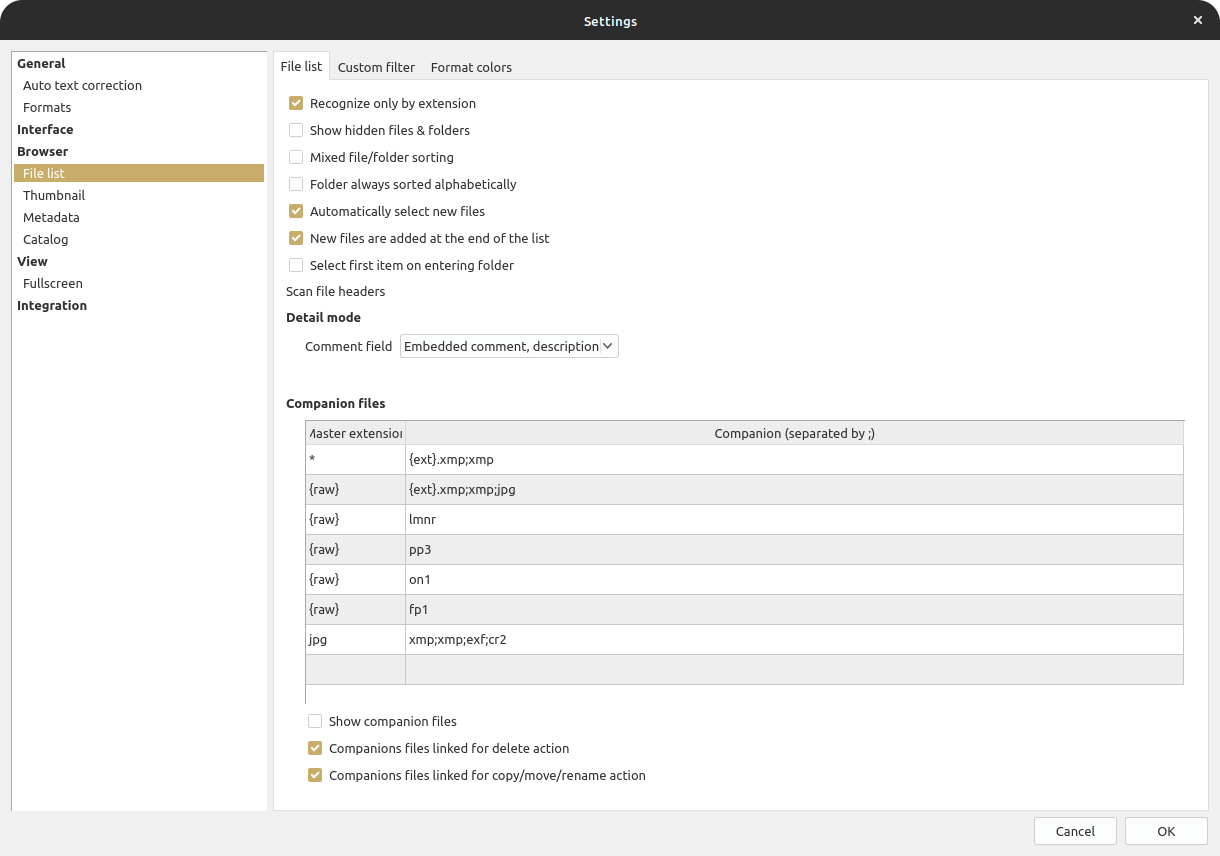

Sure, here it is.
I changed the language to english. :)
Posts: 46799
Re: hide cr2 files
in this case you need to remove the line with {raw]

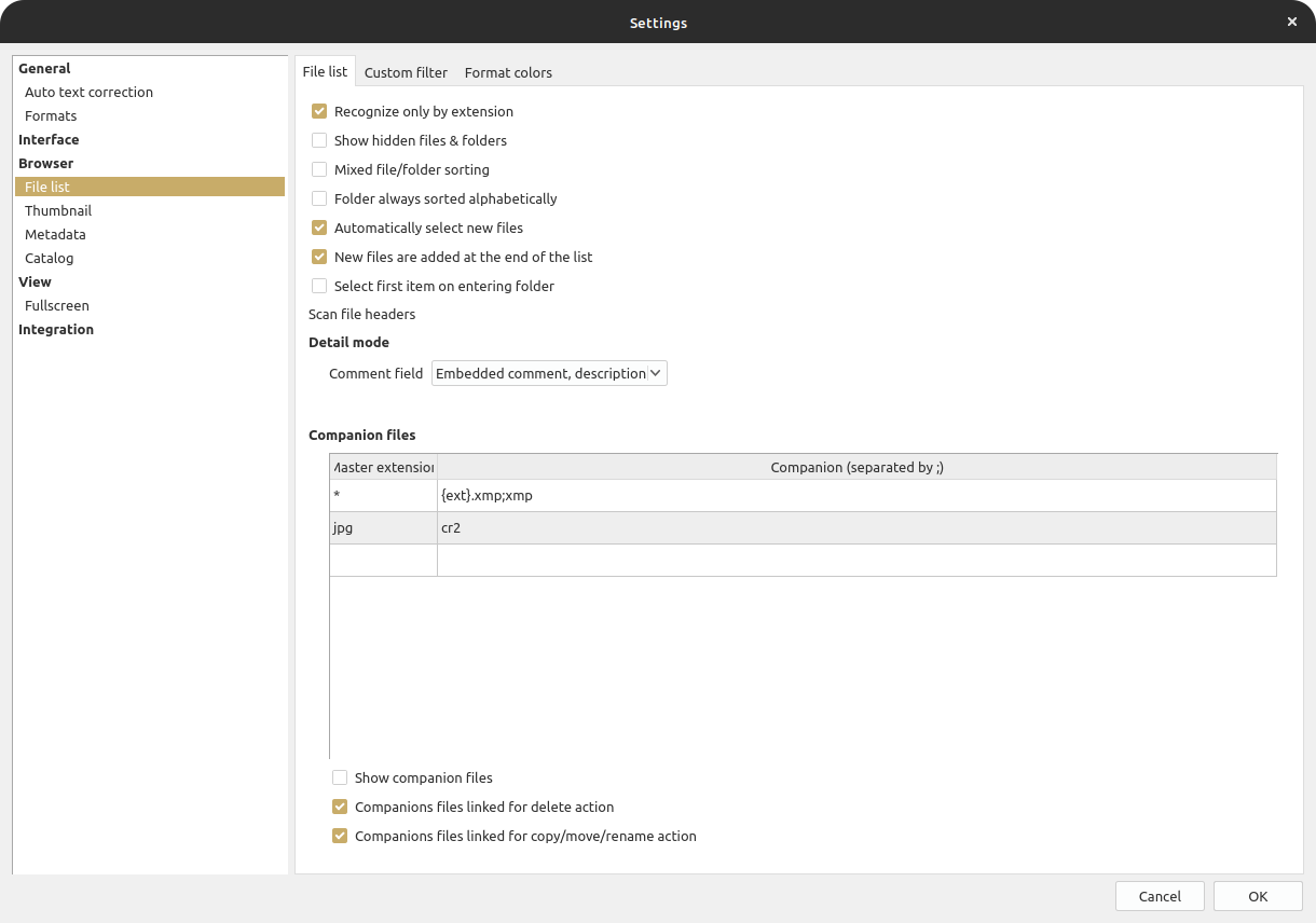

Nahuta
Posts: 6
Joined: Thu Oct 27, 2022 10:31 pm
Re: hide cr2 files
Post by Nahuta »
Hey, you're welcome! I thank you for the support! :D
Just for my understanding: I see in the report that the bug is solved in version 1.4. But the newest version I can see is 1.3.1. So you are still working on 1.4?
Posts: 46799
Re: hide cr2 files
1.4 is not yet available
Posts: 46799
Re: hide cr2 files
This problem is supposed to be fixed in XnView MP 1.4.0. Please check and confirm the bug fix here.
