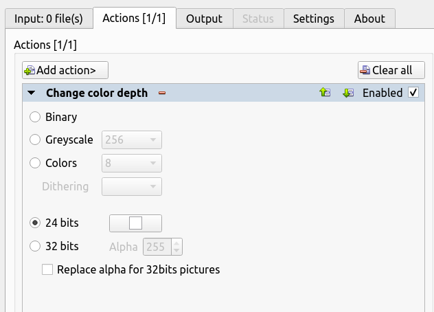

I am not very knowledgeable on alpha, but you might check if you haven't already done so whether any of the options in available this action provide the functionality that you need:
Screenshot from 2022-11-07 19-14-10.png (34.63 KiB) Viewed 4260 times

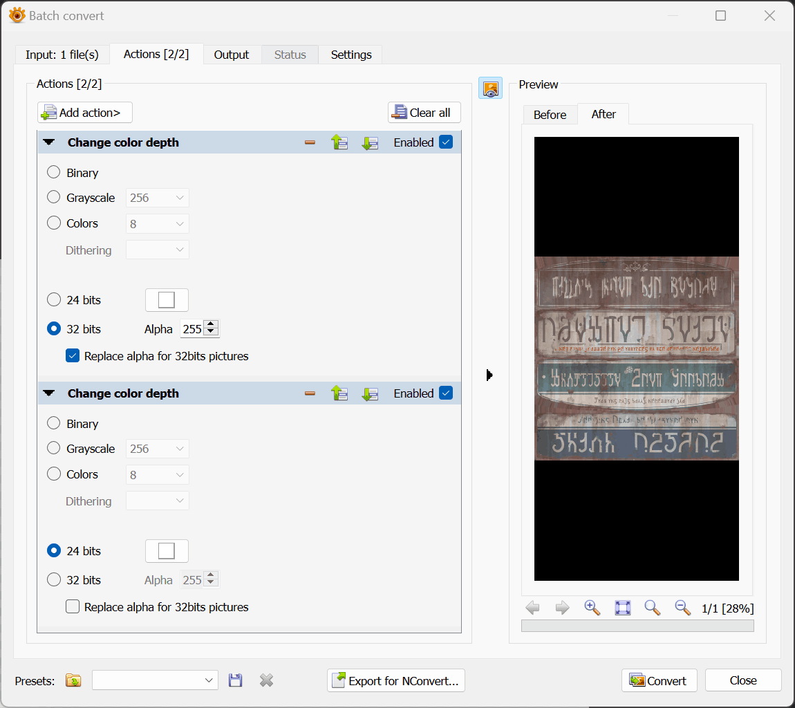

I need this action too, and I want to using it on 23,875 files in 1,729 folders, and "Change color depth- 24bits" can't do that, I put a file here maybe you can try it.
Orignal File:
Remove alpha channel
Posts: 2625
Re: Remove alpha channel action?
dedicated action would be handy, meanwhile:
1. remove alpha channel
2. (optional) convert 32 to 24 bit

Posts: 2625
xnview wrote: Thu Feb 01, 2024 7:46 am you have 'Clear transparent pixels' actions
but this is not the same as "Remove alpha channel", not sure how it works at all :D
since it doesn't affect the OP and a few of my test files.

nope. Try it on OP's file
