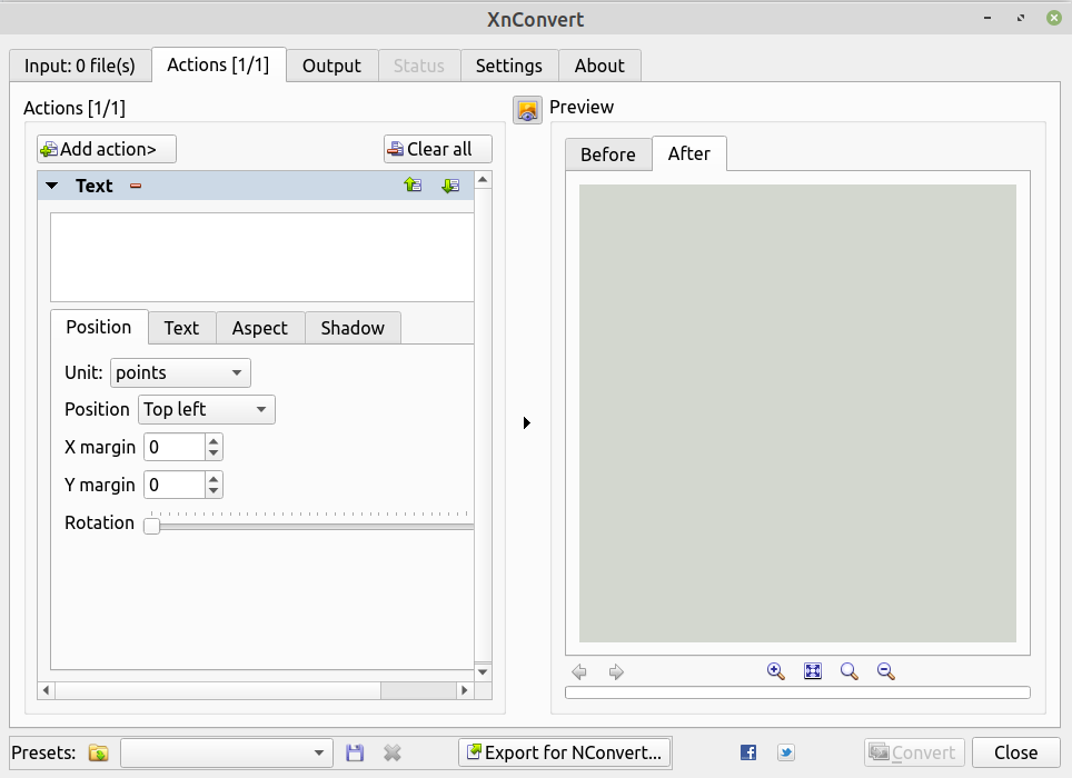

Thinking of other actions where file parameters from a drop-down list can be used as inputs, I think that the same option could probably be fairly easily added to this XnConvert [for illustration] action:
Pierre, the sole developer of all XnView software, does currently have a high workload, though... :wink:

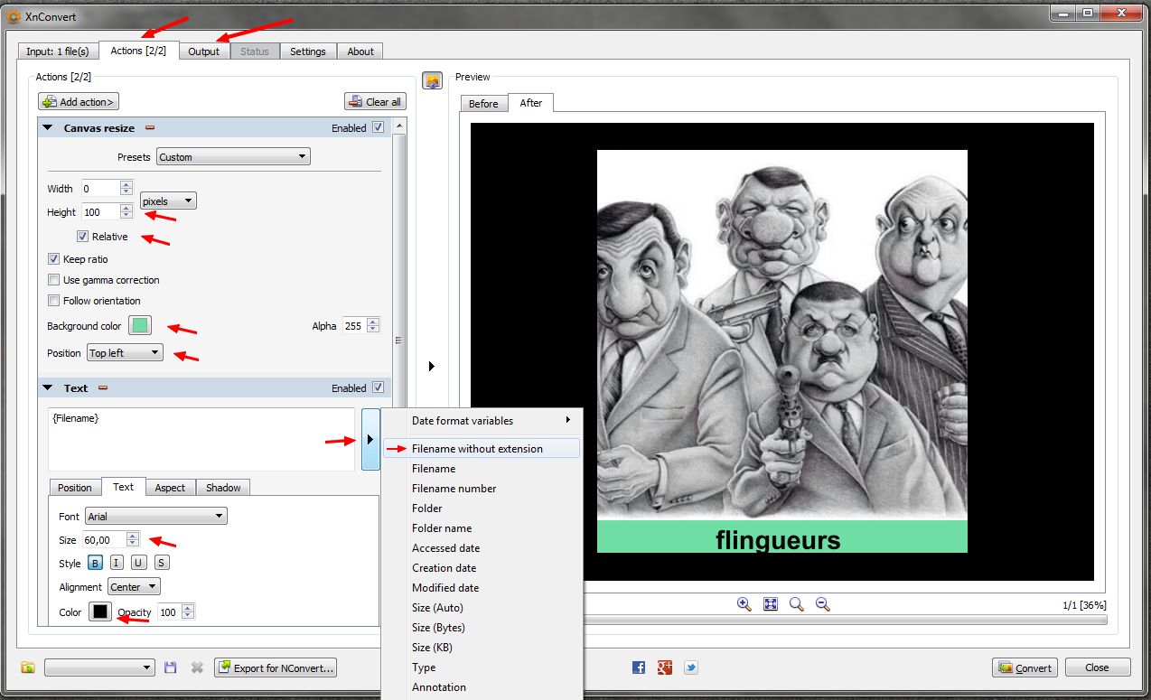

2b - If this software can't use any metadata, you can copy filenames in an new area below the displayed photo :
- Select pictures
- Tools > batch convert > Actions > Add action > Image > Canvas resize ...
Check "relative " and "keep ratio" , add for example 100 pixels height, position top left , choose background color , and see if preview is ok.
- Actions > Add action > Image > Text
With the right arrow menu of text field, select Filename without extension. Adjust font size, position, font color (!) , ... , see if preview is ok .
- Select the output folder in "Output" tab, and see also all other settings .
- "Convert"

I don't see that option that I was looking for before, see the screenshot in my first post... A screenshot?

cday wrote: Mon Nov 21, 2022 11:41 am
- (...) use the browser Slideshow function, that looks a good start, but is there any control over where the text is placed on the image?
- I don't see that option that I was looking for before, see the screenshot in my first post... A screenshot?
- In your 2nd screenshot for XnViewMP slideshow , is "Position : top left" the control you are looking for ?
- In your 1st screenshot, the horizontal scrolling seems buggy, you should see the arrow menu near the "Text" field ...

michel038 wrote: Mon Nov 21, 2022 3:30 pm
Rechecking, in both the current version of XnView MP 1.3.1 and the latest version of XnConvert 1.96, it is necessary to drag the relevant window unusually wide to see the full interface, never seen that before...
