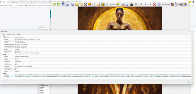

Here's a screen shot saved as jpg showing the XnView with one of the generative images in view and the properties window open via using alt+enter
The information that is important to me is at the bottom in the extras section.
