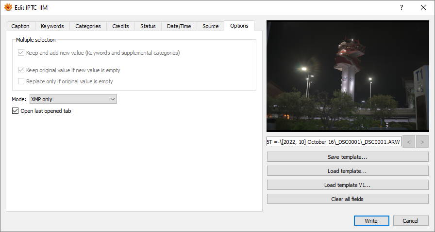

I was testing Metadata > Edit IPTC dialog on this RAW file https://www.upload.ee/files/15772839/_DSC0001.zip.html with different options from Settings > Metadata > IPTC & XMP enabled and disabled to see if they actually have any effect.
I might have misunderstood meaning of options in Settings > Metadata > IPTC & XMP for instance "export rating in XMP metadata", i thought it means "write rating to sidecar .xmp file" and probably actual meaning of this option is "write rating to XMP metadata fields that is written either to image itself or .xmp sidecar" and all options related to creating sidecar .xmp files is on tab Settings > Metadata > Sidecar?

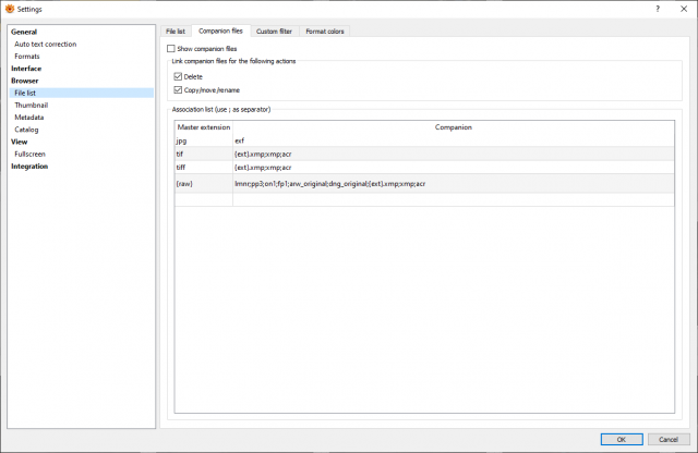

xnview wrote: Tue Oct 10, 2023 2:41 pm Yes, 'XMP metadata' can be embedded or sidecar
That option does not work for me when updating .arw file sidecar .xmp is not being created.
Test file: https://www.upload.ee/files/15772839/_DSC0001.zip.html
Here are my options.
xnview wrote: Tue Oct 10, 2023 2:41 pmSorry but i'm wrong, currently tagged files is stored in catalog. But why do you want export it state with 'Update files from catalog'? It's not a metadata entry

FKCapitalism2 wrote: Fri Oct 13, 2023 6:48 am
It works only with 'Edit XMP'.

Indeed sidecar .xmp is being created for "Edit XMP" dialog box. Will you make sidecar .xmp option work for "Edit IPTC" dialog box in upcoming version?

FKCapitalism2 wrote: Wed Oct 18, 2023 6:32 am Indeed sidecar .xmp is being created for "Edit XMP" dialog box. Will you make sidecar .xmp option work for "Edit IPTC" dialog box in upcoming version?
'Edit IPTC' is used to edit IPTC not XMP, sidecar are XMP metadatas

That's a major slowdown every RAW is 20MB re-writting 100 raw's takes quite a bit of time.
Other software (Photo Mechanic) that write IPTC tags offers option to either write IPTC inside actual raw or create sidecar .xmp.
ACDSee creates .xmp files only when you update IPTC does not even have option to write to raw files. I believe its part of IPTC standard to have either tags in .xmp sidecar or written to raw itself, whatever option user like's more. This is very nice to have a choice as some people are extra careful and don't wish to modify the raw image file itself.

But .xmp is XMP metadatas not IPTC, why not use 'Edit XMP'?

I thought that If i use other image viewer such as ACDSee or lightroom it won't show XMP fields, only IPTC. However i need to test that.
Posts: 47034
Re: Update files from catalog IPTC & XMP multiple problems.
FKCapitalism2 wrote: Fri Oct 20, 2023 7:35 pm I thought that If i use other image viewer such as ACDSee or lightroom it won't show XMP fields, only IPTC. However i need to test that.
All modern apps use XMP and no more IPTC metadatas
