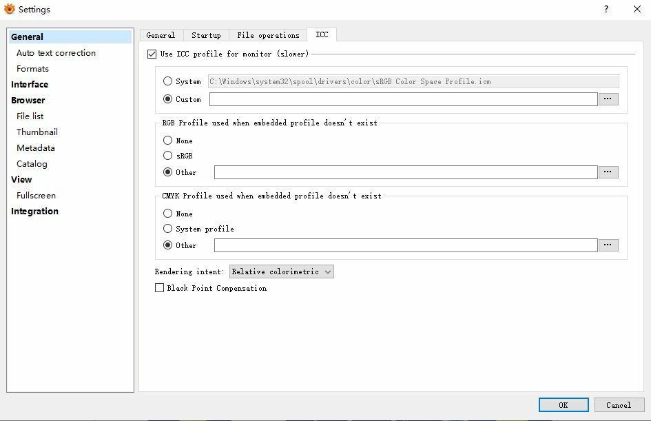

As xnview mp 1.5.4-1.6.1, open a CMYK jpg can't show the true color. I had set use ICC in xnveiw mp, but not work.
In ver 1.4.5 it can work.
Image[/URL]

Your Settings screenshot above displays, if that is what you mean, or are you trying to provide an example CMYK image?

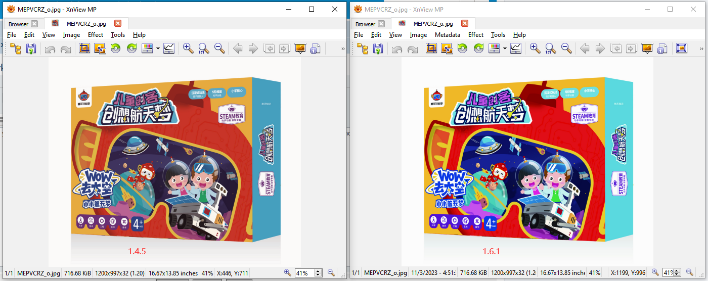

I can confirm this bug.
But you need to set CMYK setting shown above to "system" or choose a ICC in other, not leave it blank.
Because the image you provided has no embedded ICC.
Xnview 1.4.5 on left, 1.6.1 on right.
