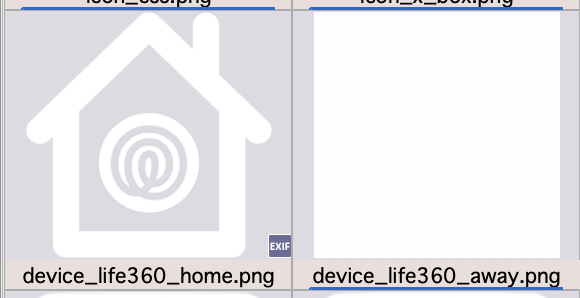

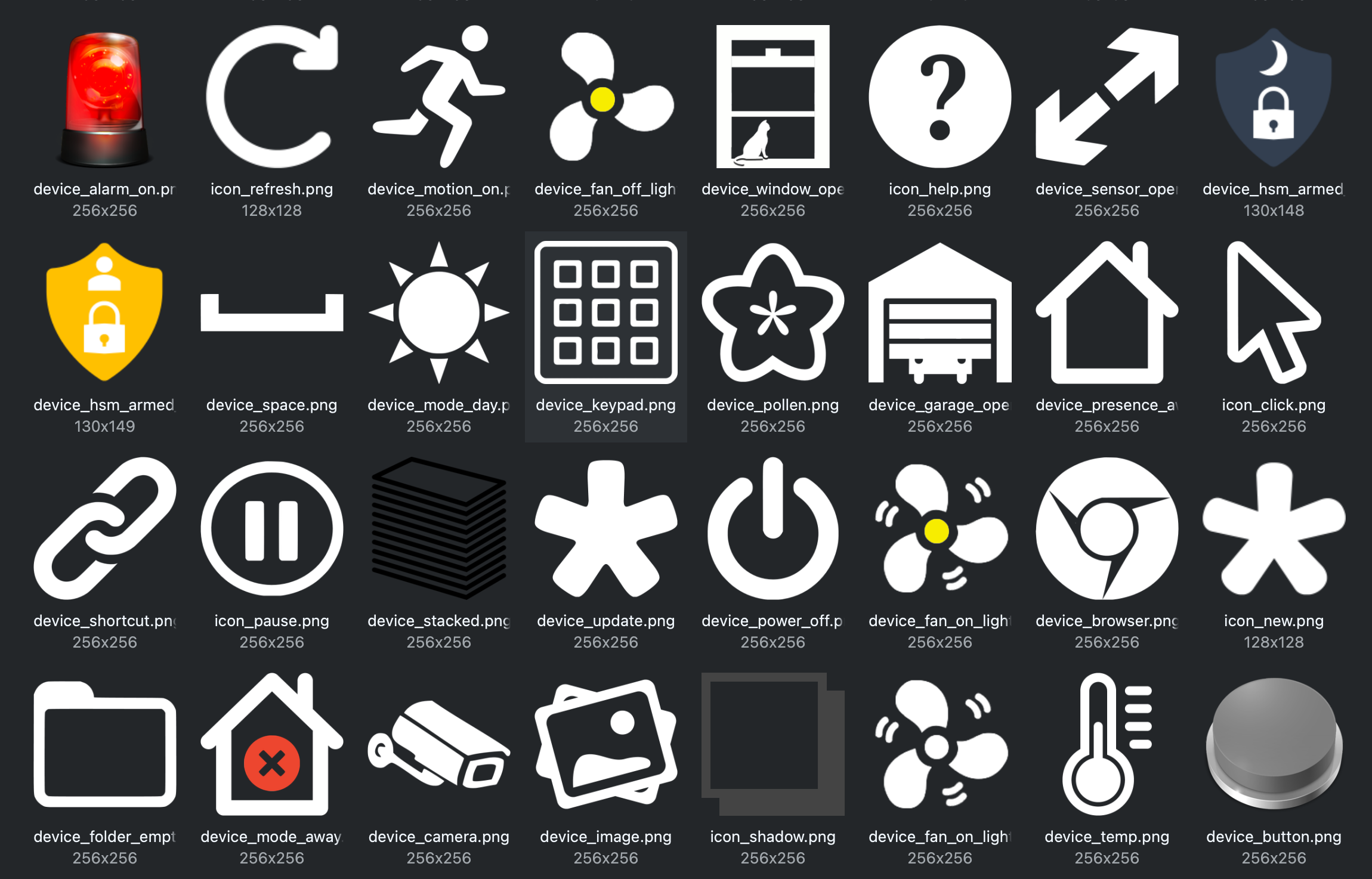

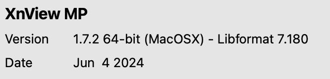

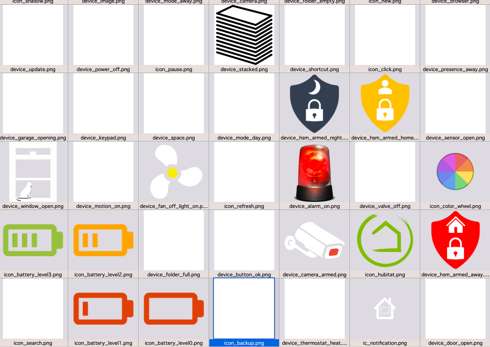

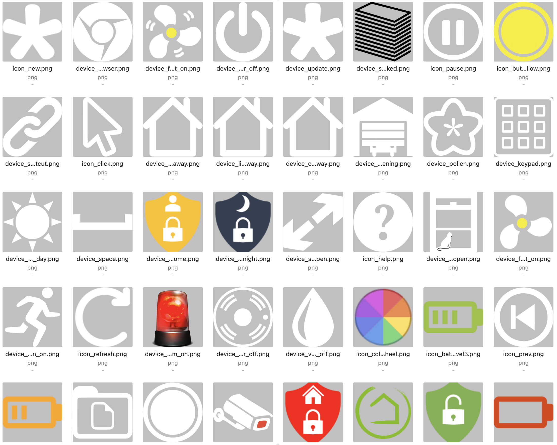

Hi, I know this is an old thread and it's my fault for not checking back for updates (I'll figure out why I'm not getting email notifications next). Anyway, I keep checking every 6 months or so to see if this transparency issue is fixed and see that it's not in the latest version (1.7.2 - mac)

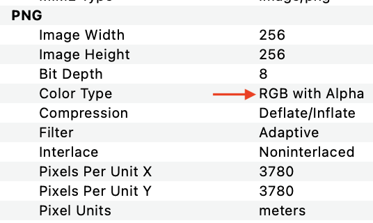

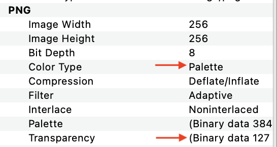

I'm not sure if at this point it's a known issue but if I can help explain it in any way I will. Using the ExifTool window I think I see what's different in images have this problem and the ones that don't. In my case the only difference is the Color Type field. If it's "Pallete" then the transparency isn't visible. If it's "RGB with Alpha" then the transparency is displayed correctly. Both images are 8-bit.
In my case I don't know why the images have different Color Types but I'd guess this happened when I compressed some of them using a tool like tinypng.com.
I also attached an image of a Mac app called PicSee which displays the transparency just fine:

Sorry, I meant to attach a good and bad png image but forgot. I've got lots to choose from but I tried to pick 2 that are as similar as possible with only the "Color Type" as the difference
GOOD:
BAD:

jpage4500 wrote: Wed Jul 17, 2024 2:49 pm BAD:
this one in not 32bits

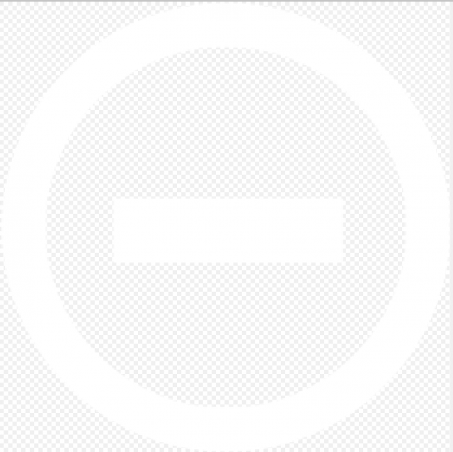

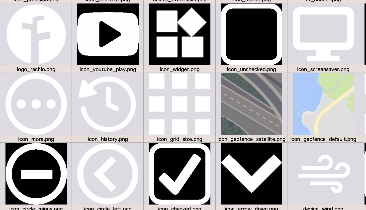

xnview wrote: Thu Aug 29, 2024 1:24 pm This problem is supposed to be fixed in XnView MP 1.8.0. Please check and confirm the bug fix here.
it works!!

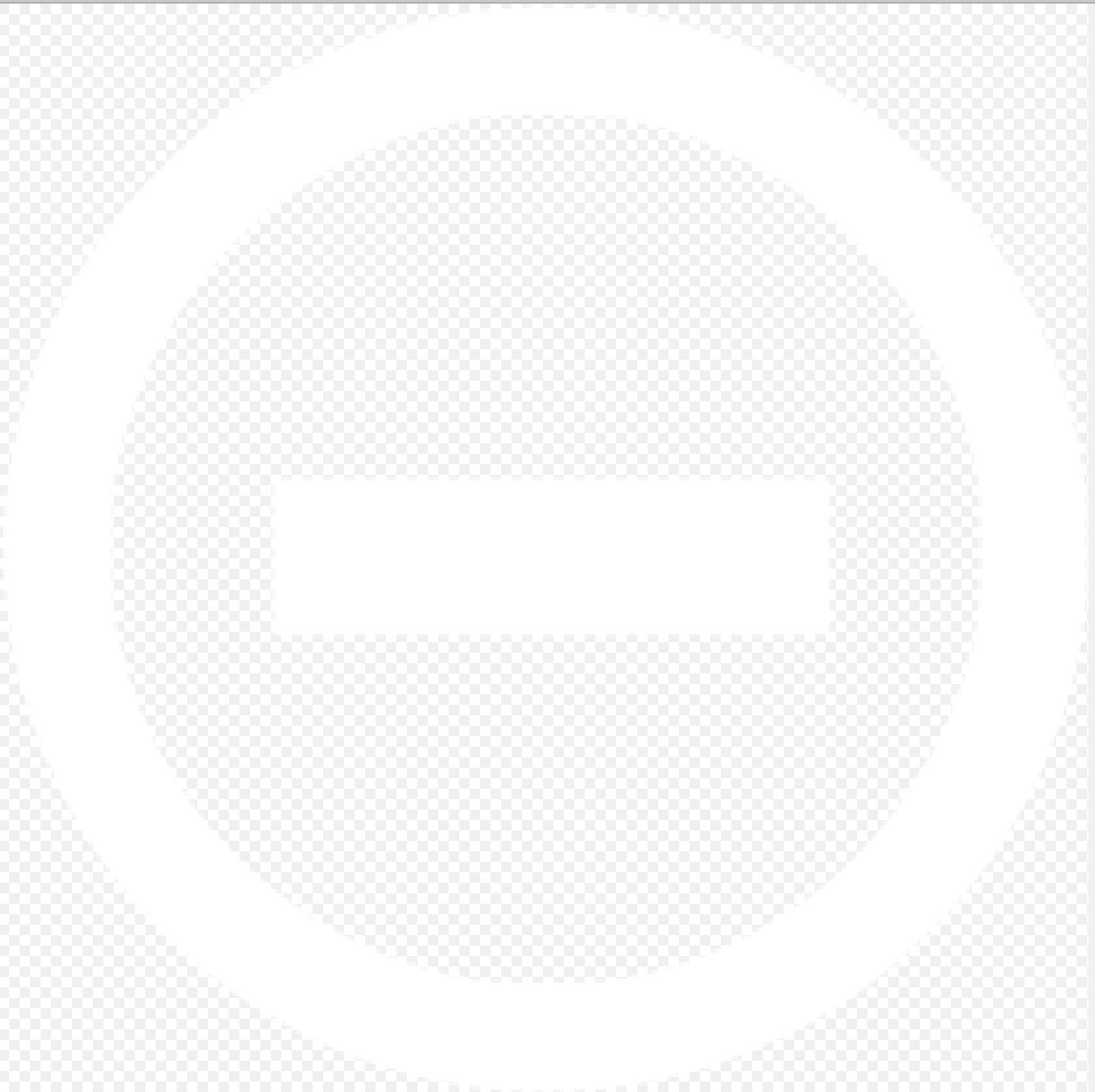

I do see some of them have black backgrounds and others have gray backgrounds which is a little confusing but at the end of the day I can finally see the image so I'm not complaining!!
FWIW here's an image with a black background in full view -- so it is a transparent background (second attachment)
