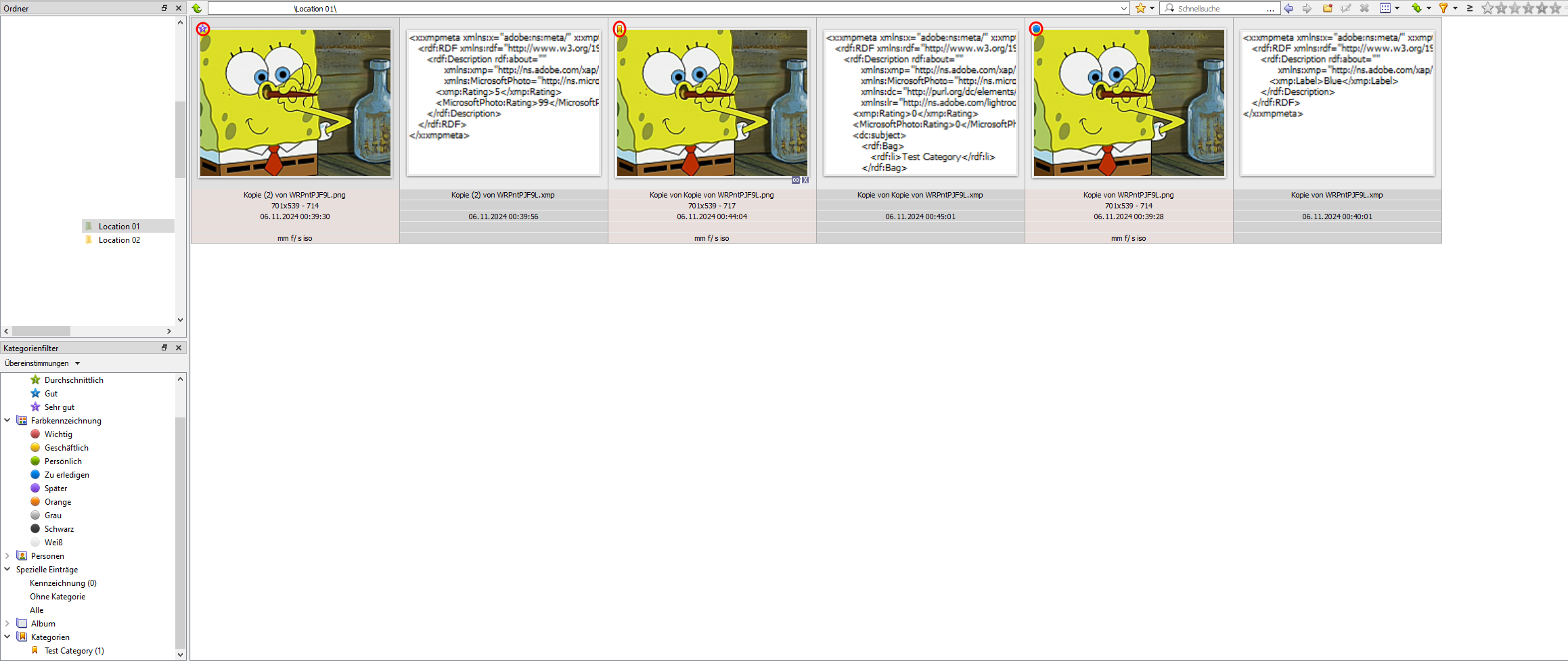

When applying a category filter in the category filter panel, the attached sidecar is not moving with the file.

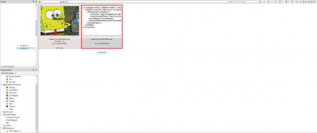

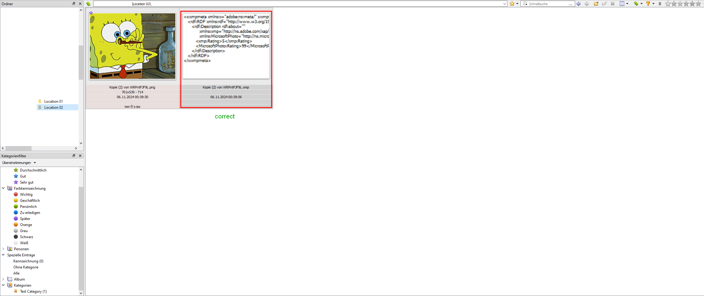

When no filter is applied, siedcar hidden or not, is moved with the file as in the settings described.

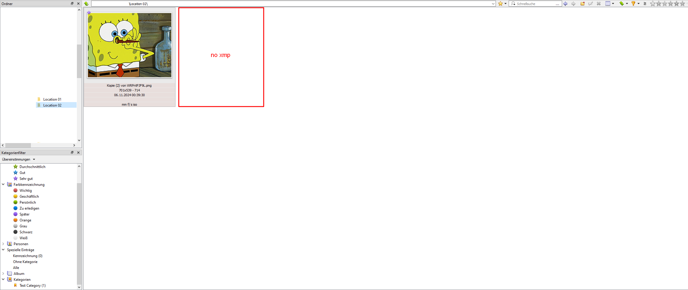

The filter in the top bar shows only the media file, not the xmp as expected (in case it is shown). Moving the file in that case also moves the xmp that's hidden because of the filter (in that example I used a 4 star rating).
Doing the same in the category filter panel also hides the xmp but it does not move it with the file.

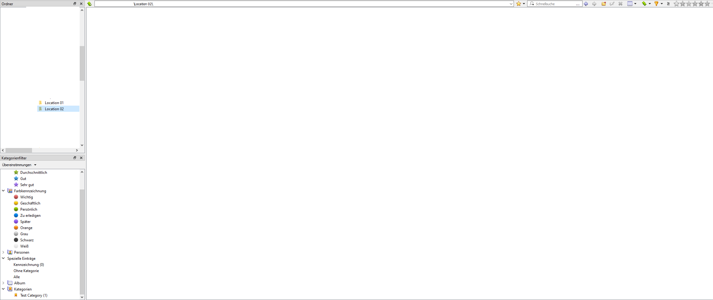

I have a source folder (Location 01) with files that have a rating, a label and a category - all with attached sidecars And I have an empty target location (Location 02)

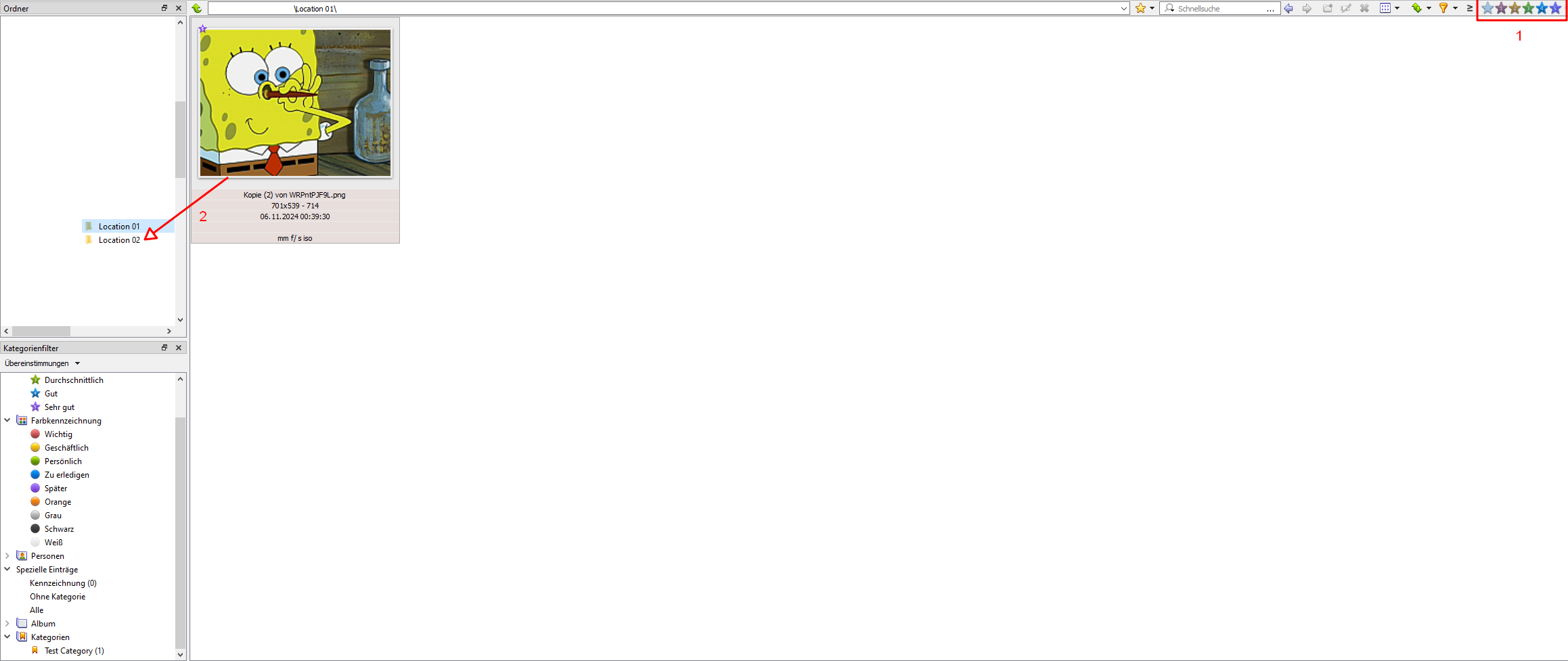

Expected result (using the filter in the browser):
I filter for rating and get the file as a result (without the xmp)
I move this filtered file in my target location In the target I see the file and its attached sidecar

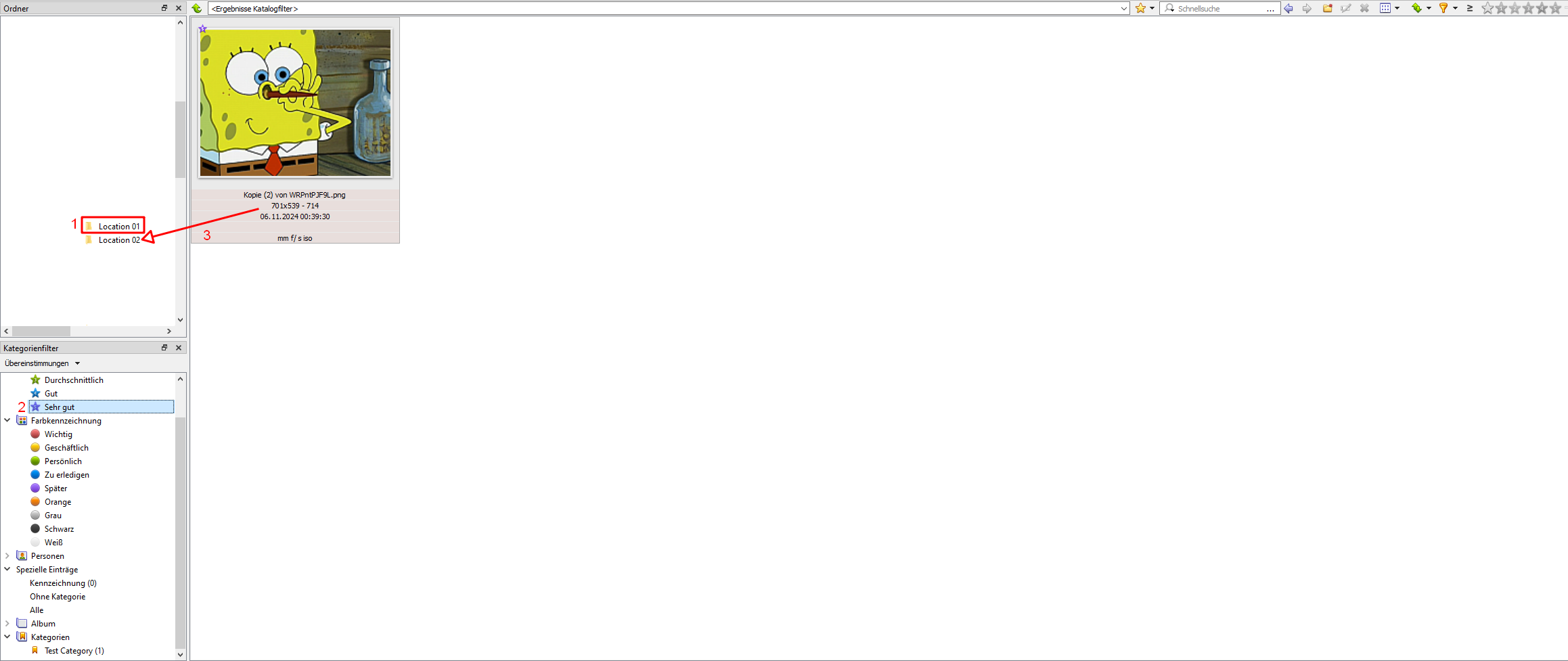

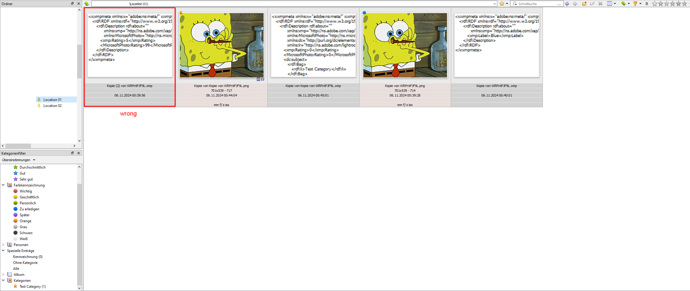

Actual result (using the category filter panel)
I move this filtered file in my target location - same as before In the target I see only the file - no sidecar It is left behind in the source folder and wasn't moved/copied/cut/deleted with the file as it should
