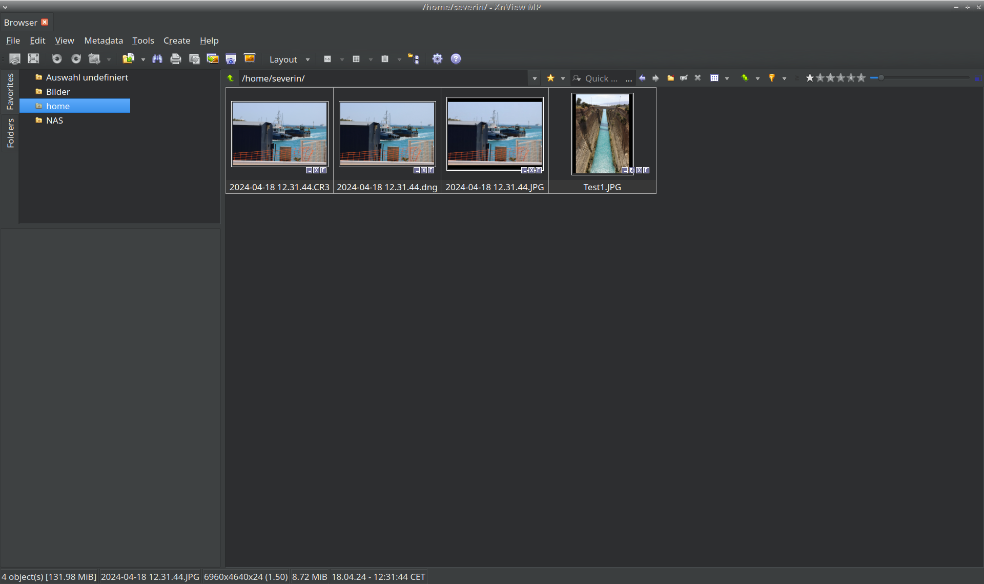

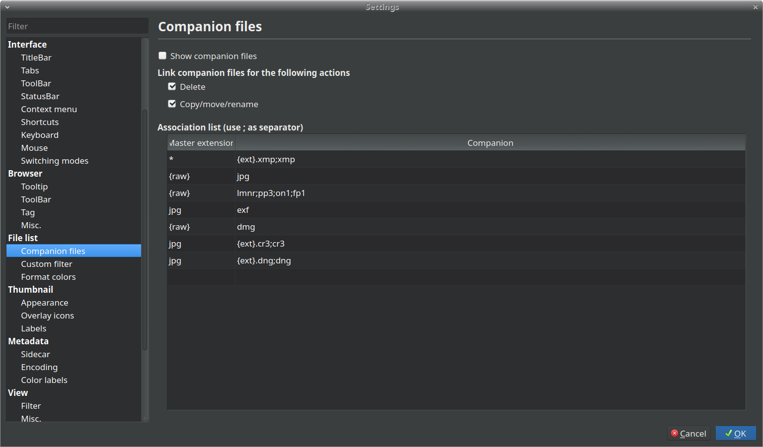

I have 1 thing that is nasty for me:
For my fotos the formats I use are .jpg, .cr3 (canon raw image) .dng and .dng.pp3
Beeing in the browser mode, I have displayed all 3 formats as single image.
I would like to have displayed them as 1 image only!
I'v tried different setings, but I didn't got it to work. All 3 are displayed.

Re: handle files as sicecar
you need to define which is master extension jpg or raw, in your settings you have both

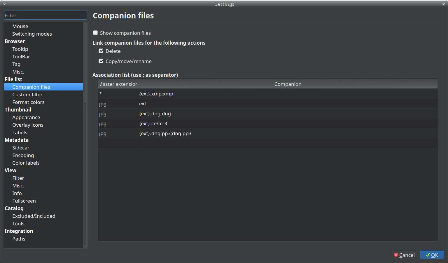

Thank you so much for your answer!
I adapted the settings, I deleted all {raw} entries in this list:
Copying and moving is working fine.
But I still have displayed all three files (dng, cr3, jpg) as single images in the XnView-browser... :(
Other idea?
even after restart? I've tried jpg=>dng;cr3, and it works

These are my files in the directory:
In the XnView-Browser, it looks like this:
What am I doing wrong?
