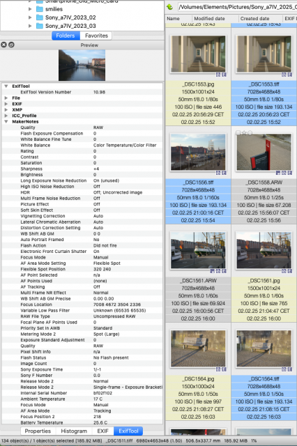

XnView MP 1.8.5 macOS Catalina Version 10.15.7 (19H2026)
The old problem persists.
When I start XnView MP, select a thumbnail, click EXIFTool, all variables are displayed:

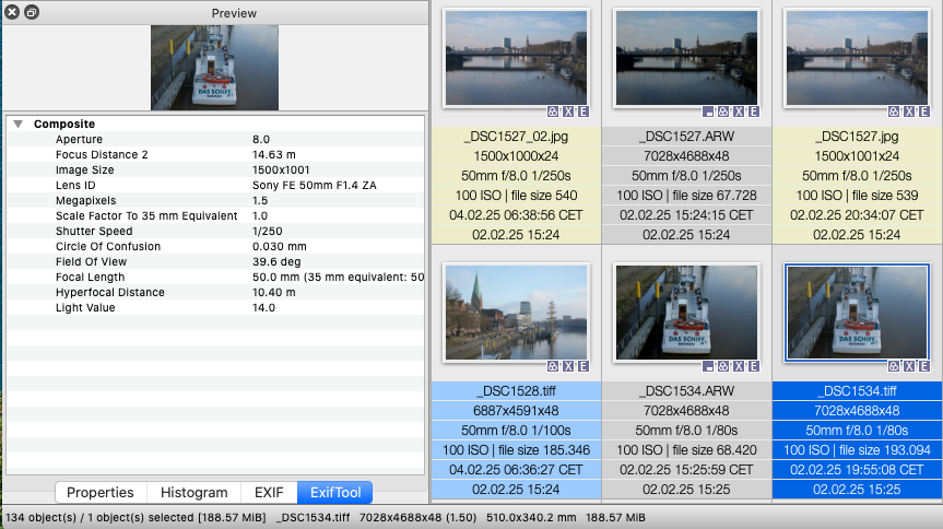

But when I select another thumbnail, the EXIFTool veriables are chopped off:
I've already re-installed XnView several times, but the strange behavior remains. I've even deleted the hidden files in the User/.config/xnviewmp except for the Thumb.db and the XnView.db files without success.
