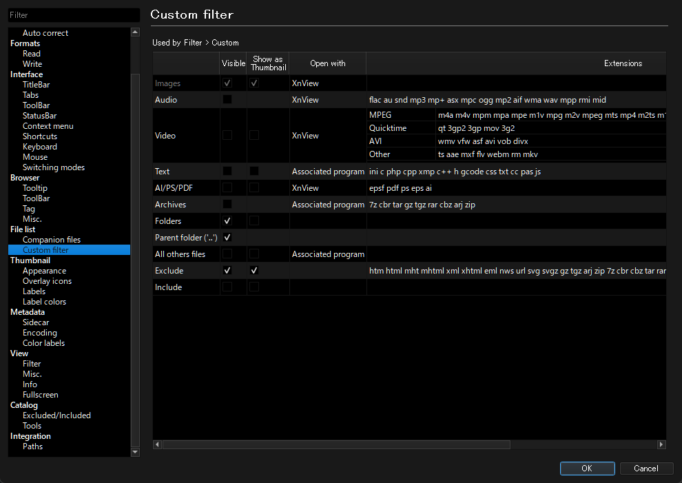

・why do you select zip files to batch convert?
As the necessity to keep my favorite images and their related ZIP files together in the same folder has risen, I've resorted to importing entire folders rather than choosing files one by one
・you can remove zip file in the file list tab
this?(imagefile) This seems to be the only relevant setting I can find.
The problem is that even if the software can hide ZIP files in the file list, it still forcibly loads all files during batch processing.
XnView instantly detects images and counts non-image files as errors, but occasionally it reads the contents of ZIP files and converts them as images.
Could you please confirm if 'tiger.7z' alone is sufficient?
(hile it might be somewhat understandable if uncompressed files were read due to the specifications, the fact that even files compressed in 7z's lzma2 format are being read in my environment is a serious problem.)
