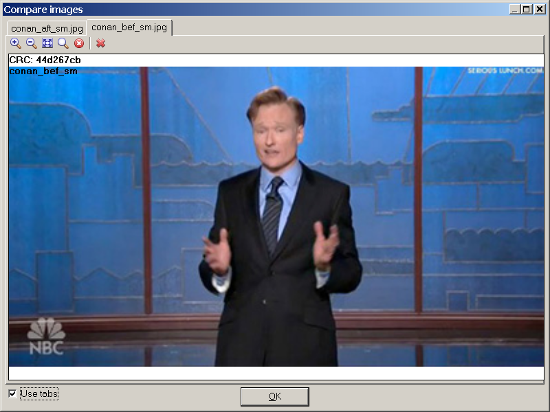

Sooo.... then perhaps is better to have the "Use tabs" option in Compare window - like in XnView Classic?
m. Th.

I didn't find the "Use Tab" option. Is that available only in the windows version?XnTriq wrote:I'm like Yossi. Comparing images “on top of each other” is the most effective way for me.yossic00 wrote:For me it's easier to spot differences when comparing images by alternating between them so I prefer to put them on different tabs to compare.

I think so.m.Th. wrote:Sooo.... then perhaps is better to have the "Use tabs" option in Compare window - like in XnView Classic?
- Req: Compare Panels in Tabs
- Modal vs. Non-modal: Implementation criteria (long)
- 0.64 Win/64: Compare Tab Issues
Yes. XnView Classic, to be exact.yossic00 wrote:I didn't find the "Use Tab" option. Is that available only in the windows version?

... Yes especially with this "Before/After" plugin concept ... so only one tab is enoughm.Th. wrote:Sooo.... then perhaps is better to have the "Use tabs" option in Compare window - like in XnView Classic?
