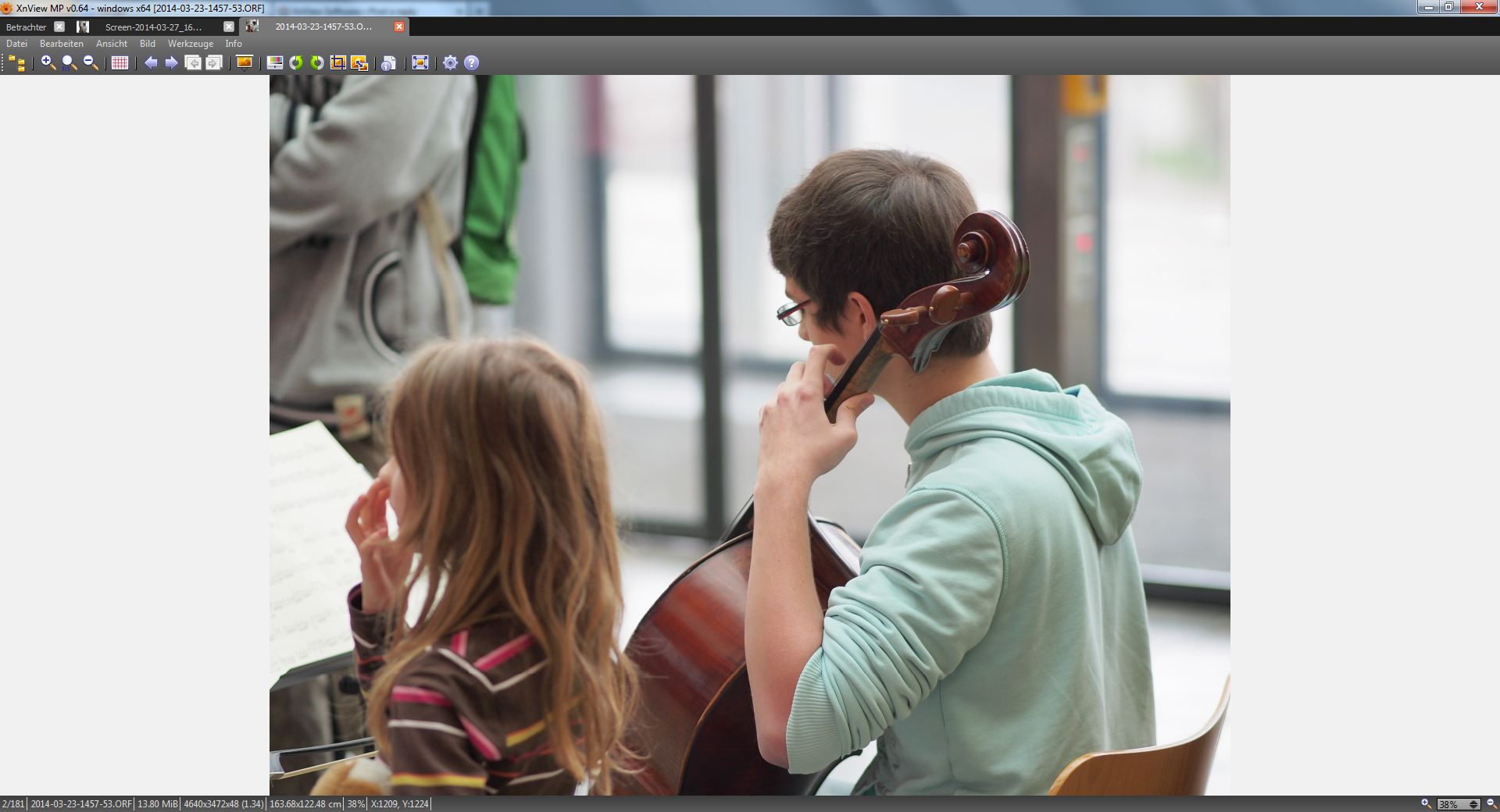

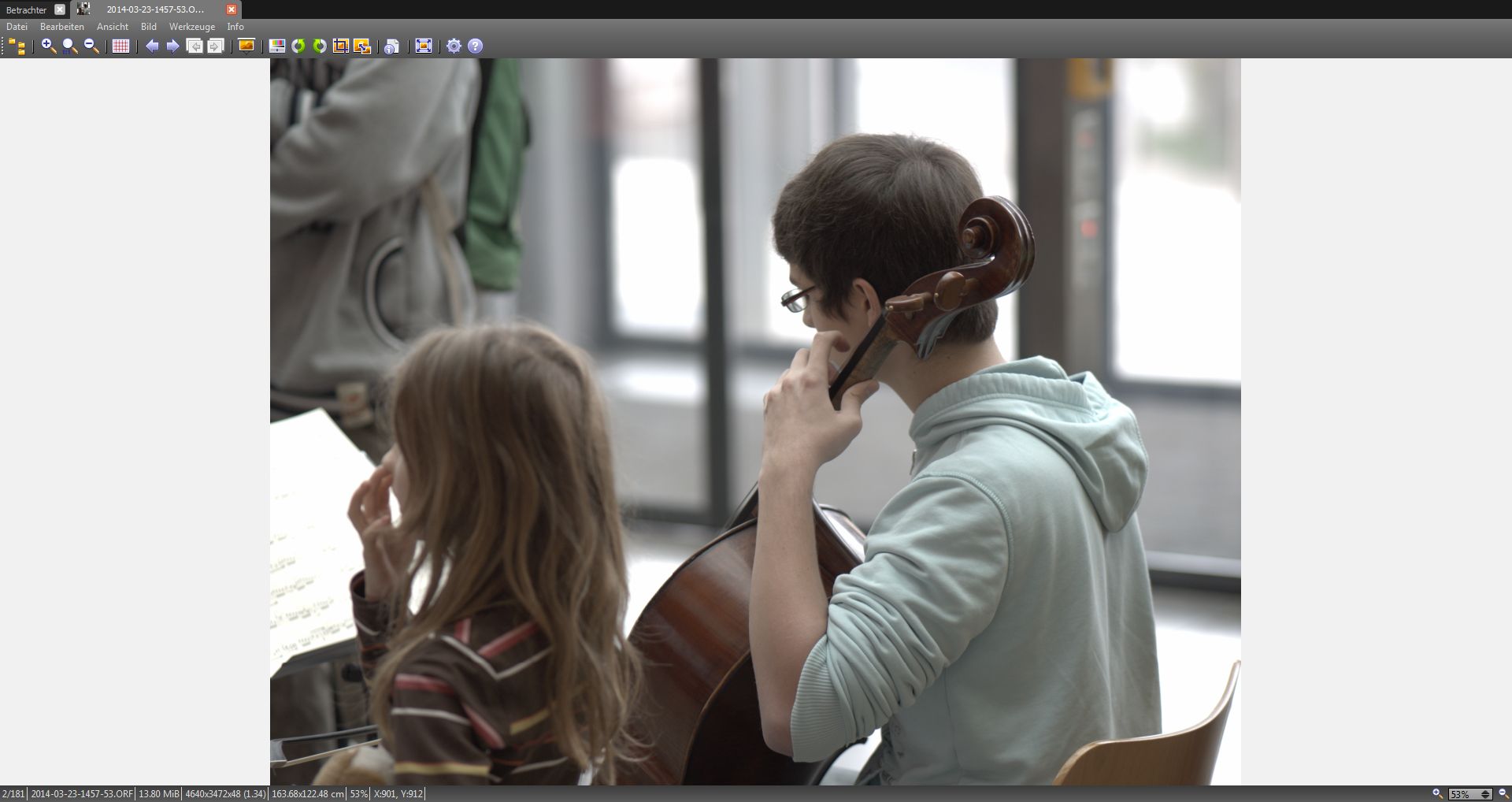

As far as I found them I tried to change the raw settings. I found some in the menue of batch convert. There I changed the settings to "use camera WB" and I increased the brightness.
This I how the preview looks like:
and this is the embedded preview:
You can see that the colur is missing to some extend. I didn't find any other place to change raw settings
Regards,
hic

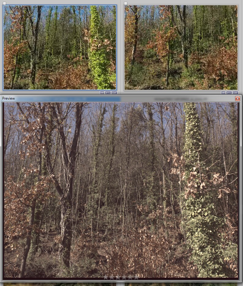

Re: Raw preview of ORF leads to green image
Hmmm... I'm really not convinced that it is a problem here.
Perhaps you must know that the 'preview' is a 'doctored' image of the actual RAW data. Let me say it again: When you look at the embedded preview you look at other image than the actual RAW image. Usually some curves, increased contrast, saturation, sharpen etc. are applied.
See bellow the difference between the thumb in top-left and the actual raw data (bottom) of the same file of a high-quality digital back (Hasselblad H4D). The purpose of the raw file isn't to look 'pretty' but to keep as much information as possible. That's why, generally, in order to keep as much as they can from the dynamic range of the light which hits the sensor, the colors appear dull, lacking contrast (especially if the files use Adobe RGB color space). If you do some PP the image will look indeed prettier, but this isn't the purpose of the RAW data.
There are brands/cameras known to do enough PP before saving the thumb in the Raw file. Perhaps that's why Photoshop's Camera Raw plugin has a special tab (page) dedicated to presets for each camera model they support which mimic the PP applied by the camera on the Raw data. Hence if a beginner wants to see his Raw "exactly like he saw it in Explorer", he can go on that tab and choose "Normal", "Vivid" etc.
But if you think that it is really a problem and you don't mind, you can upload your file somewhere (eg. sendspace.com) and send the link to me through PM to have a look at it in another program (Photoshop, ACDSee, ZPS etc.).
