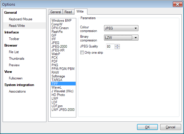

I need to batch convert a folder of TGAs to TIF format, and will need to repeat the process, so I'm creating a Batch Processing script which I can reuse. In the Formar dropdown, I've selected: "TIF - TIFF Revision 6" as the output format.
I notice that when I click "Options" there is a "JPEG QUALITY" setting. I've tried setting that field to 100 and then saving the script, but when I reopen it, it's been reset to 80 again. Does this setting have any bearing when converting from TGA to TIF format? Will I be getting a perfect 1:1 conversion from the source TGA to output TIF? Since both formats are uncompressed, I presume the result should be a perfect pixel-to-pixel match except for file type.. Is that correct?

TIFF is in general a lossless image format but the JPEG compression option, like the JPEG file format, is lossy...grafical wrote:I need to batch convert a folder of TGAs to TIF format... when I click "Options" there is a "JPEG QUALITY" setting. Does this setting have any bearing when converting from TGA to TIF format?
If file size isn't important you could save to TIFF with LZW compression or any other option except JPEG and maintain perfect image quality.

The TIFF 6 format provides a selection of alternative compression methods: the JPEG option when used enables much smaller files to be created although with some potential loss of quality, as in the JPEG image format. The TIFF format can contain multiple images -- a large number -- in a single file and so a TIFF with JPEG compression may sometimes be a useful format.grafical wrote: I still don't understand why a "JPEG Quality" option exists in a TGA to TIF conversion in the first place.
Yes, the JPEG quality setting shouldn't be displayed for other compression methods; that is confusing and has been raised recently, and is an open issue at the moment.grafical wrote:Are you saying that by enabling LZW compression, I'm automatically disabling the JPEG Quality setting ... When I select LZW Binary Compression the JPEG Quality setting doesn't get grayed out or anything suggestive of it being disabled...
Then you can use TIFF with any compression method except JPEG...grafical wrote:What I need is an exact conversion from TGA to TIF, while preserving 100% image quality, regardless of file size ... I don't care how large it is as long as it's 100% pixel-to-pixel identical to the original TGA, where every single pixel in the resulting TIF will have identical RGB values to the corresponding pixel in the source TGA.
You're not concerned about file size, but if you were it would be worth testing alternative compression methods as the optimum compression that can be obtained may depend on characteristics of the image, such as the presence of large areas of the same colour.

The displayed JPEG quality setting will only affect the file size when saving to TIFF with JPEG compression option selected...
Are we saying the same thing now? Your TIFFs were large, much larger than with the JPEG option selected, even with a high quality setting?
If you select TIFF with the LZW option selected there will be no doubt that the resulting image is identical to your orignal image.

With the above settings the TIFF file created will be uncompressed whether the original file is colour, grayscale or 'binary' (black and white)...
With the above settings the TIFF file created will be LZW compressed whether the orignal file is colour, grayscale or 'binary' (black and white)...
The JPEG quality setting (in practice) only has an effect when 'JPEG' is displayed in the 'Colour' window -- it's not an option for black and white because the format only supports colour and grayscale.
I realise it's confusing and that's why there is a pending request to hide the 'Quality' window when JPEG compression is not selected... (@xnview... )

Ok, so if I had None and None selected for the two drop-downs, I was by default converting without any JPEG compression at all. That's good to know because I was contemplating having to reprocess several thousand images!
