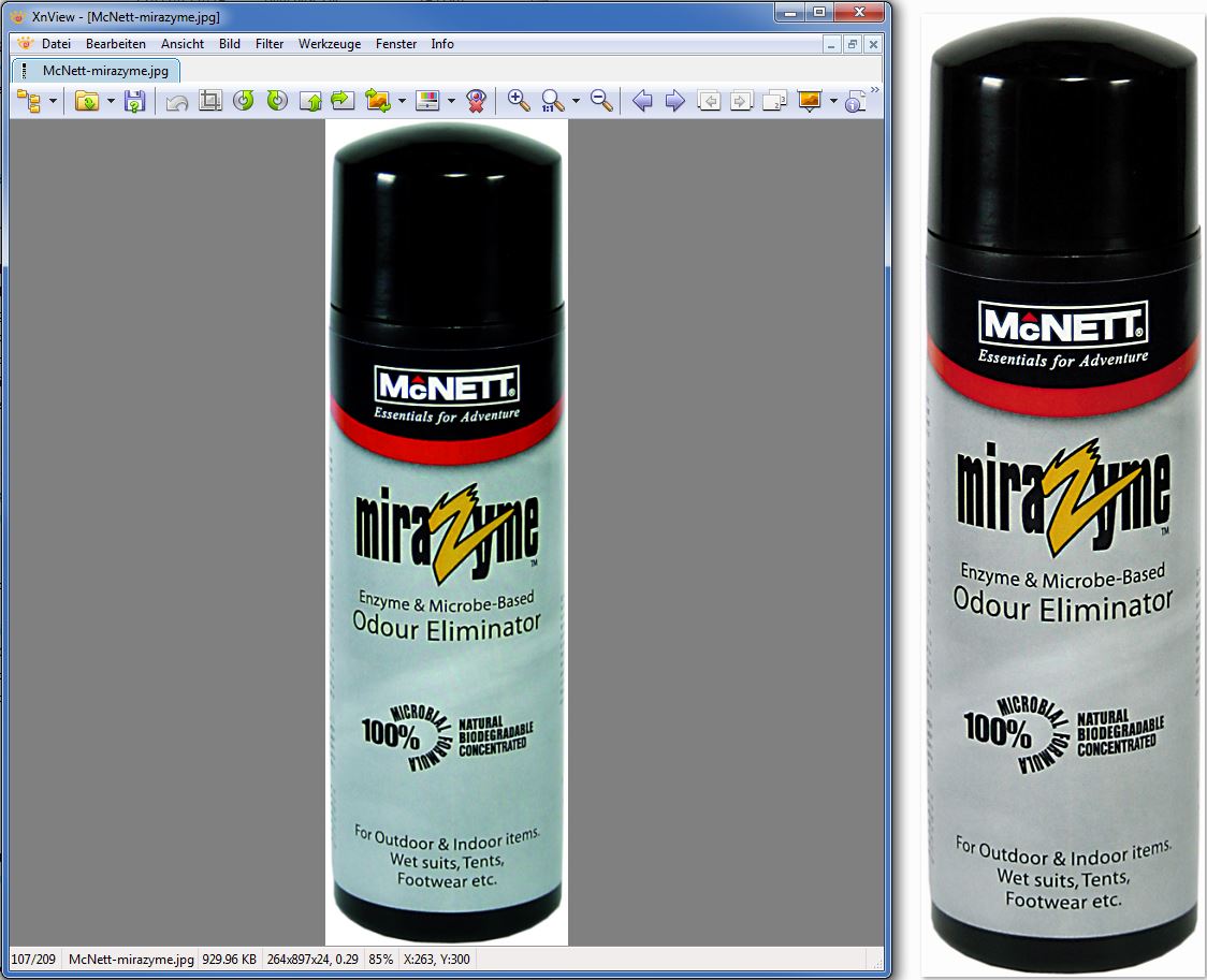

This JPG image is shown in XnView with a greenish label, where the real bottle is grey...
System Preview on win7 64bit shows the colors correctly.

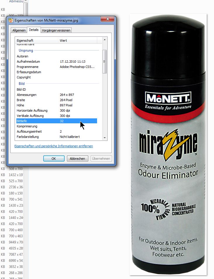

The system info says it's a 32bpp image, xnview (2.32 AND MP 0.72) see a 24bit image, and distort the colors. See screenshots:

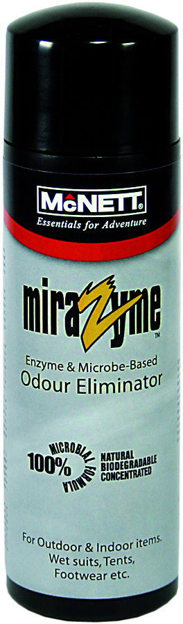

And the offending file here:
Interestingly, chrome, FF, Opera AND IE also render a greenish label...
Wrong colors: 32bpp jpg gets interpreted as 24bpp

Re: Wrong colors: 32bpp jpg gets interpreted as 24bpp
- Color model: CMYK
- Color profile: Europe ISO Coated FOGRA27
XnView will tell you that “This picture will be converted to RGB with 8bits per component.”
