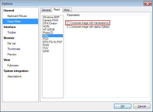

I'm no expert on transprency but XnView 'Classic' has this setting you could try:Markhaen wrote:when I open a PNG in Chrome and copy the image (right click). Then I paste it (ctrl+shift+v) in XnView and all the transparency is turned to black.
... while waiting for further help if needed.

I downloaded your PNG and the 'Alpha' setting below the transparency setting in my sreenshot above has an effect, could you try that?Markhaen wrote:Any other idea?
In the View menu you also have 'Use alpha channel' which I have enabled, although it's greyed out with your image open...

I tried again with "Compose image with alpha (32 bits)" and it does exactly the same.
For me too the 'Use alpha channel' is selected but greyed out...
