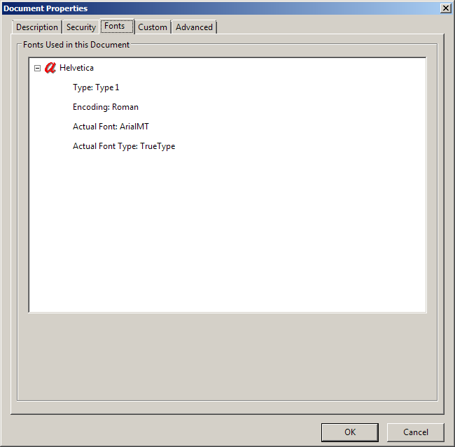

When you create a multi-page pdf file (or batch scan to pdf), XnView adds "Helvetica" font information to the file.
This does not allow you to configure the download of the file to the information system (the file is not considered a scan, and recognized pdf file).
How to remove this information?

For example, save the image to pdf (see attachment).
In the properties of the pdf file there is information about the font "Helvetica". What for?

Hatters wrote: In the properties of the pdf file there is information about the font "Helvetica". What for?
I don't know, possibly a requirement of the PDF spec, or an arbitrary assignment in the PDF creation software (third party, I think) used by XnView software.

XnView MP 0.92 writes font data to File > Properties > Fonts , same issue now fixed in Classic...
