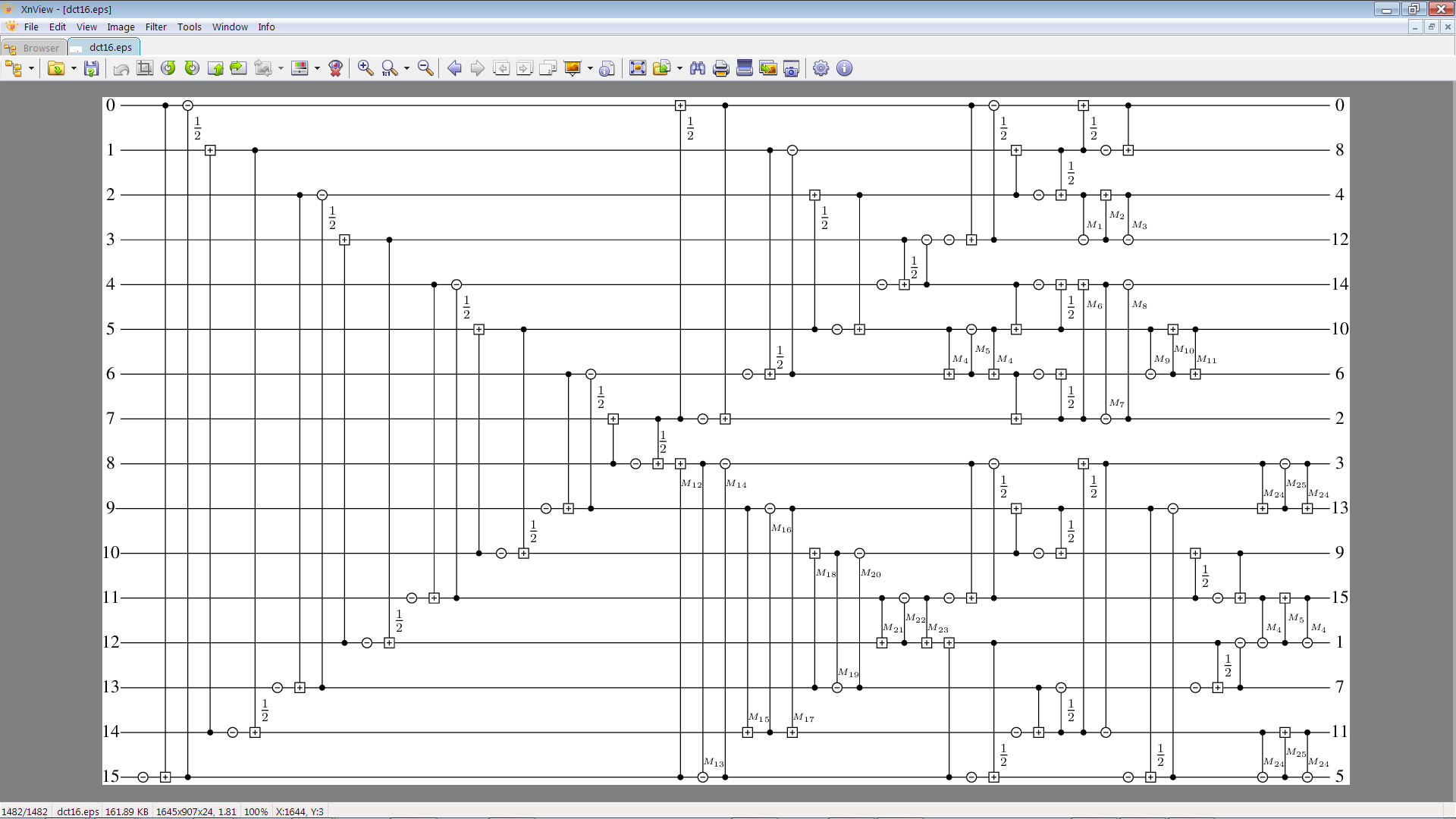

On a Xiph.org Daala page I stumbled over an EPS file, and can open it with a PS viewer application (Ghostscript wrapper converting PS or EPS to PDF on the fly, displaying it with whatever displays PDF, an old Adobe reader 9.x in my case.) The standard action for EPS on my by box is "open with XnView". XnView 2.30 shows some garbage instead of the EPS, and crashes when I try to zoom (mouse wheel.) I'm not at all sure that this is a new issue, because I very rarely open EPS files.

Posts: 4566
Re: 2.30 crash report for EPS

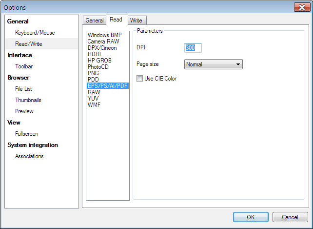

The dct16 file you linked to opens normally using File > Open... in XnView 2.30 with Ghostscript installed, using the setting below:
Is that any help?

cday wrote:Is that any help?
Yes, apparently 2.30 is incompatible with 2.24 INI-files, it just crashed again when I tried to reproduce your settings, and it also "forgot" its old layout. For Windows 2000 I simply deleted the old INI-file, now trying the same for Windows 7... Yes, that works. Now I'll only have to reconstruct my old layout and the old buttons with a text editor, sigh. :|
