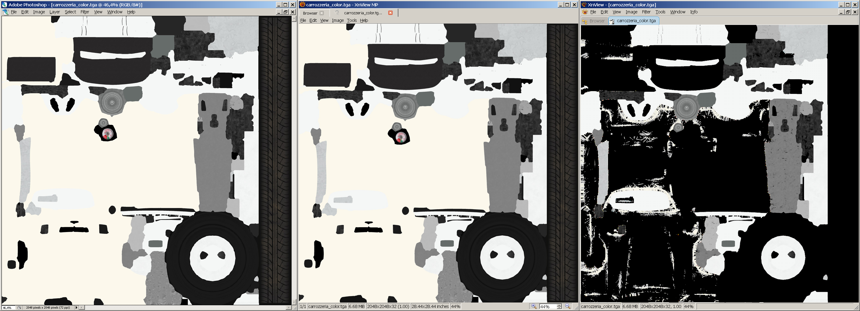

I found a problem in Xnview.
It happens only with TGA 32 bit. In other words TGA with an alpha channel!
if I see a TGA with alpha and turn off the alpha from the view menu to only see the rgb channel I see a completely wrong picture full of black areas!
If I tell Xnview to only show me the alpha it shows a correct alpha!
If convert the TGA to other formats like Tiff I can see the rgb channels perfectly!
In this first picture you see the same image shown in Xnview and in Photoshop. Both application are showing only the rgb channel. The alpha is turned off in xnview too. As you can see in xnview I see a lots of black areas! This happen continuously with every tga 32bit.
https://pixhost.org/show/789/42423263_tga_issue.jpg

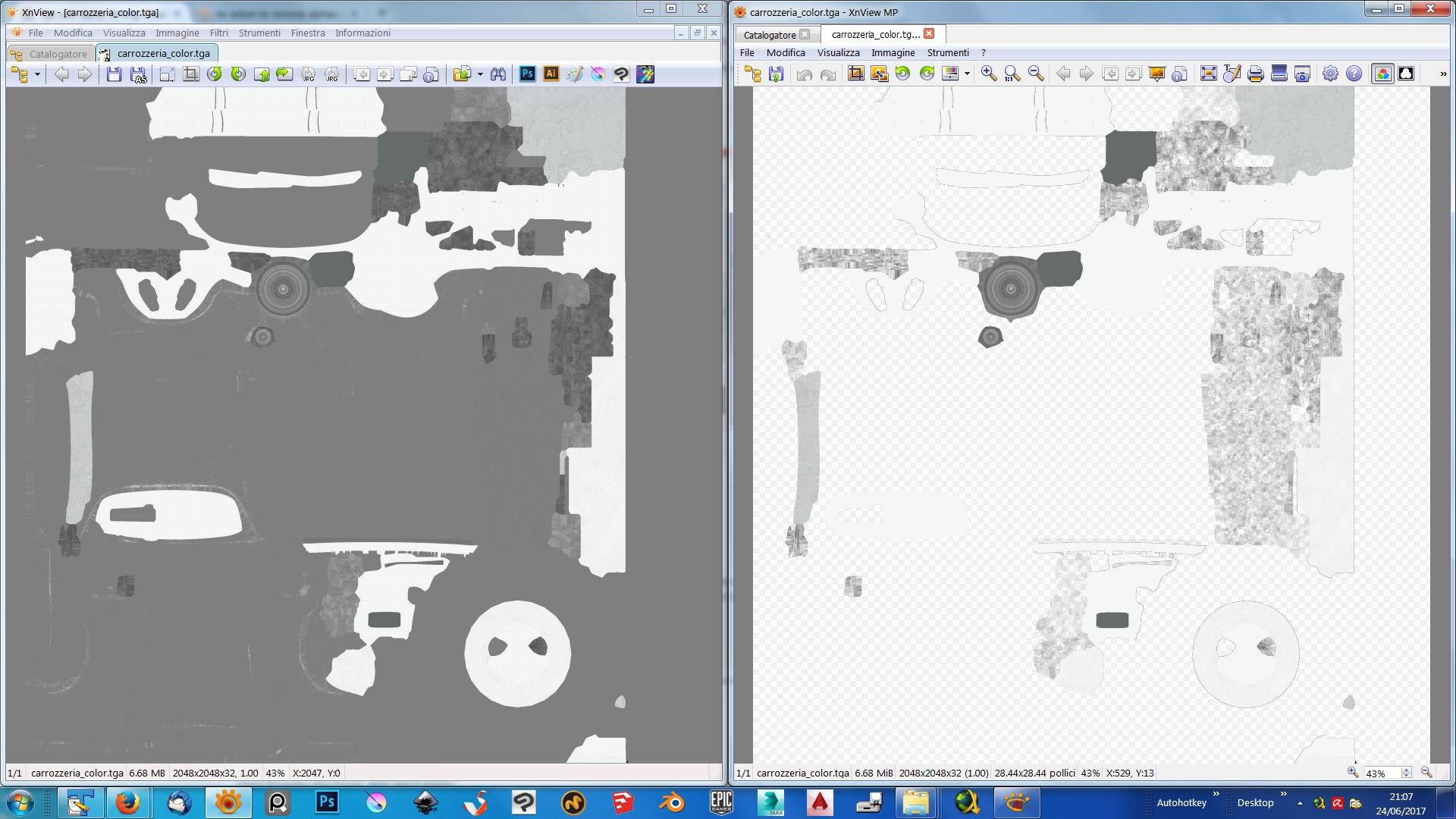

In this second picture you can see the alpha both in photoshop e xnview. No problem here. Same alpha in both application.
https://pixhost.org/show/789/42423259_tga_alpha_ok.jpg

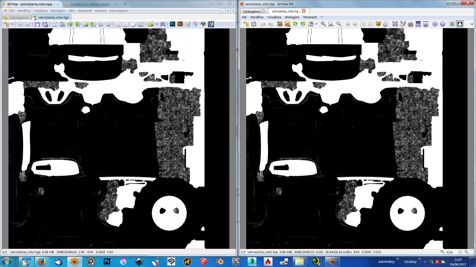

In this third picture I show you the same image converted to a 32bit tiff. Perfect visualization in both photoshop and xnview!
https://pixhost.org/show/789/42423241_tiff_ok.jpg

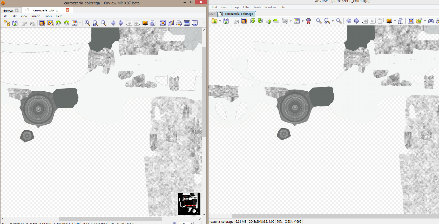

Reproduced with XnView v2.40
- Download carrozzeria_color.rar.
- Extract carrozzeria_color.tga and open it in XnView Classic as well as XnView MP.
- Deactivate View → Use alpha channel in both Classic and MP.

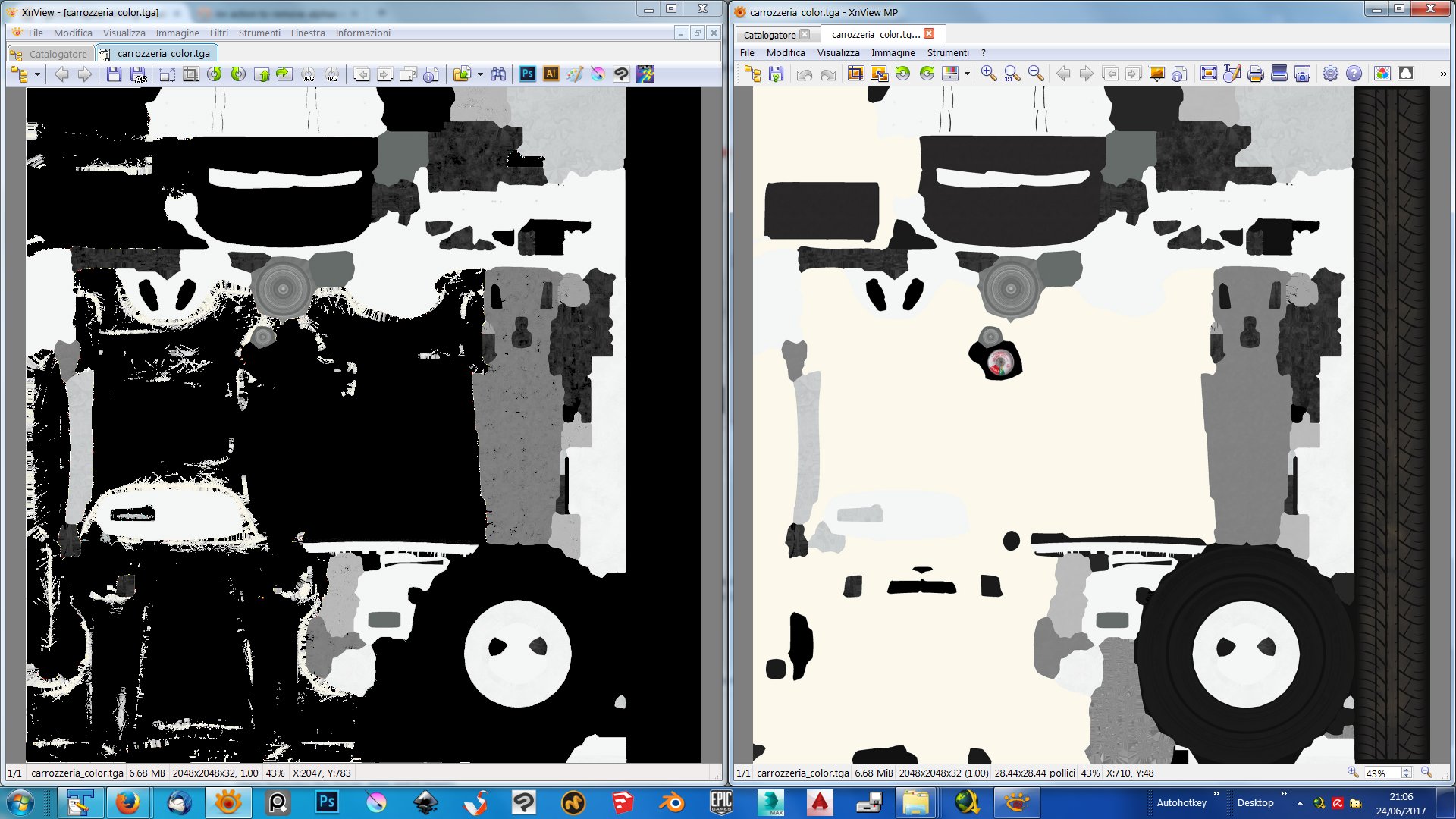

The same file opened bot in Xnview and XnviewMP.
With alpha on (weird), with alpha off (the ugly black areas), with only the alpha visible (this is ok!).
