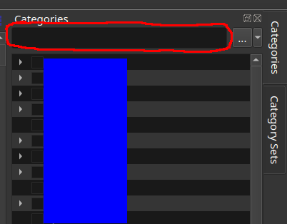

The autocompletion suggestions for tags, as in the "Categories"-panel (again: in the bar I've circled in the attached image), is an obvious neccesity, to identity the exact tag one means. Hence the tags have to be identified and then input in the filter/search-bar, as a distinct entity. (so the program would have to treat it as a separate and distinct entity, from the boolean operators and parentheses)

Another thing that should added to the search/filter-bar, would be setting its scope:
All images in the catalogue, or a set folder …or multiple folders. (with options for including sub-folders, and when including subfolder, also having the option to exclude specific sub-folders)
Also, in addition to the search/filter-bar, having a panel that looks more or less like the "Categories"-panel, that can be used to choose tags for the search/filter-bar, would be a nice option.
Where the "Categories"-panel lets you press boxes, to set the tags of the selected image(s), this panel would have you press boxes to include tags in the search bar …and press the box again, to sets the tag to be excluded instead. (a third press, removing it from the search/filter-bar)
Naturally, any OR, XOR, and/or parentheses would have to be adjusted in the search/filter-bar, rather than in the panel.
Adding that panel, should be very easy, as it would, in large part, be a copy of the existing "Categories"-panel. (they would just need something to set it apart, visually, to avoid confusing them for each other)
As for where to place the search/filter-bar…
Putting in a down arrow (as on the layout menu on the toolbar, or to the right of the circled area in the attached image) on the "quick search"-bar, to allow one to switch between quick search and tag search/filtering. (or quick search, what XnView calls categories, embedded/sidecar tags, and categories+embedded/sidecar-tags)

Having used ctrl, and ctrl+alt, in the Categories panel, I have found that it works in a rather awkward manner, and it is difficult to manage to get it to have the right set of tags included/excluded. It can be relatively easy, if you're just including tags, particularly if they're all close to each other, but…
It would work a lot better and smoother, if it worked the way I propose:
Click on a tag, to include, click on it again to exclude, and once more to unmark it.
Further, adding folders (for marking as included/excluded) to the Categories panel, along with "Ratings", "Colour Label", "People", "Special Items", "Album" (none of which I use, BTW), and "Categories", and treating them the same, in terms of marking/including/excluding, would be great. Far better than just the "Global", "Current folder", and "current folder (recursive)".
…and speaking of recursive, being able to right click on an item on the Categories panel, to get a context menu where you have the choice to include sub-tags/sub-folders/… or exclude all sub-X, would also be good.
…and have a filter bar, linked to it, where all the items you include/exclude in the Categories panel are automatically included (and all those you include in the filter bar, automatically get marked in the Categories panel), and where you can use further regular expressions, to include OR, XOR, and parentheses, to further refine the filtering.
