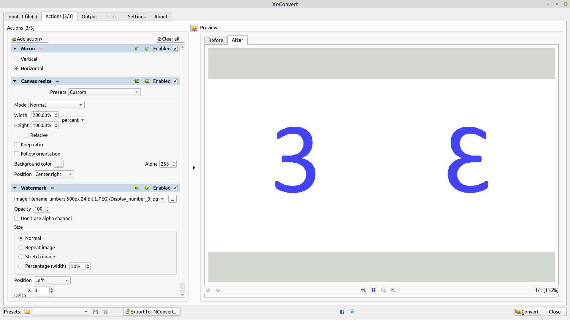

Might be possible now using XnConvert and some ingenuity...
Is that what you mean megetious69?
A practical problem though: there is no way I can see to change the watermark image, so only one file could be processed at a time.
Should be possible using NConvert command line tool in a batch file, but I think the mirror function would have to be added?

It is interesting that you have previously seen an app that provided various forms of output. It would be helpful if you could outline clearly the functions requested, first the basic options desired, and then suggestions for more complex options that you think could be useful. Any form of illustration, even hand drawn and photographed if necessary, would be helpful.
Meanwhile, some basic outputs could probably be created using XnView MP with simple scripts created using one of the many scripting utilities such as AutoHotKey or possibly a more basic utility.
I have also requested that the XnView MP View > Mirror options be added to the command line utility NConvert to enable some basic mirror function to be created using batch files.
- Posts: 4629
Re: Another symmetry idea: Clone, flip horizontally and join
NConvert in fact already supports mirror horizontal and vertical actions but with these options:
A number of symmetry effects could therefore be created now using NConvert scripts.
-xflip : Flip horizontal
-yflip : Flip vertical
