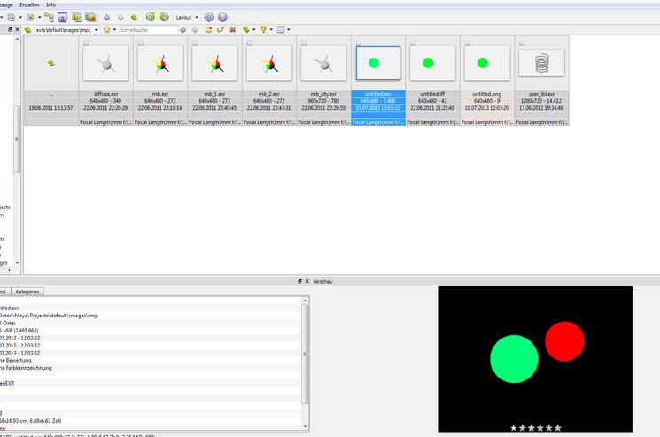

I have the same exact problem with the alpha in the thumbnails. My picture has a black alpha channel. Now in the viewer the picture is shown correct but in the thumbnail view I see nothing because the alpha is black. ;)

I attached a screenshot where you can see that the thumbnail is not showing the red ball because in the alpha it is black.
Posts: 47518
Re: OpenEXR incorrect gamma and missing alpha
jho wrote:I attached a screenshot where you can see that the thumbnail is not showing the red ball because in the alpha it is black.
could you send me the file?
